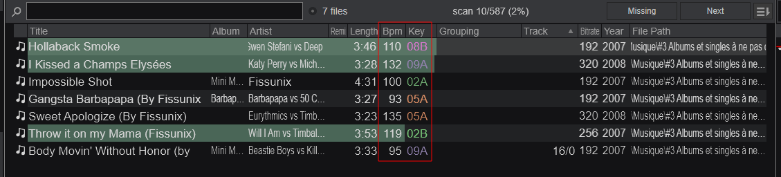

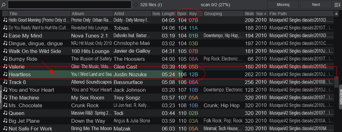

Just to illustrate my point:
Here's a screenshot showing an ongoing track analysis, where BPM and Key are already analyzed. So what stands the "etc" for in Analyze for BPM etc?
Thanks for taking my question under consideration 🙏

could be that it pulled bpm & key from tags before being scanned.
geposted Tue 13 May 25 @ 2:33 pm
This makes sense. It's possible indeed.
This involves that there is some internal flag somewhere saying "this tracks requires re-analyzing", and I would be happy to access in my filter 😉
geposted Tue 13 May 25 @ 4:08 pm
scanned=0 should do that
I see you used 'false' in your original filter, but I'm not sure if that actually works

Perhaps they were used with VDJ7?
If so they would have been scanned with VDJ7, but will be rescanned since the scanning has improved since.
