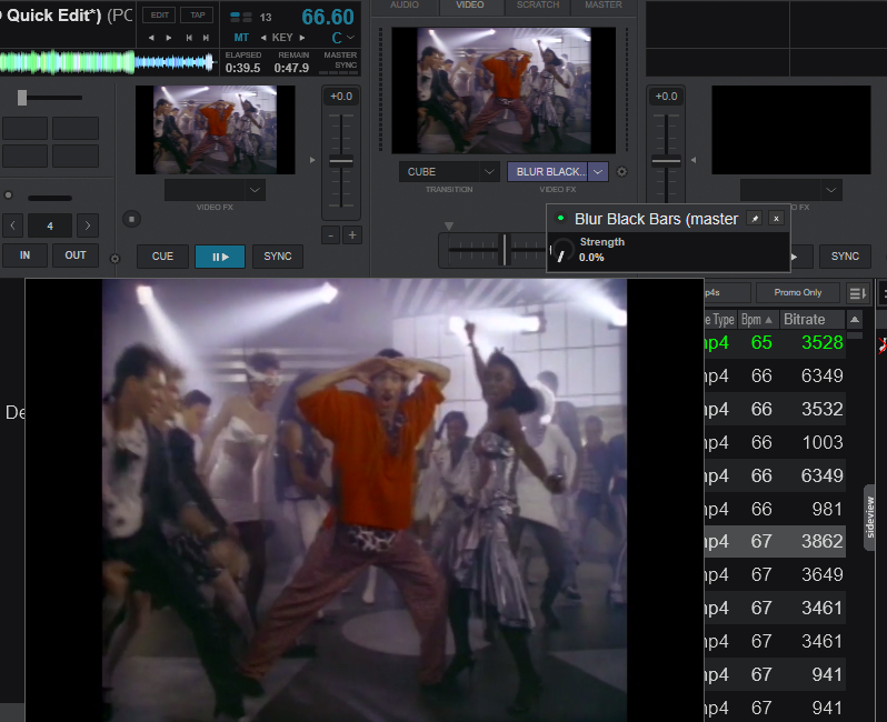

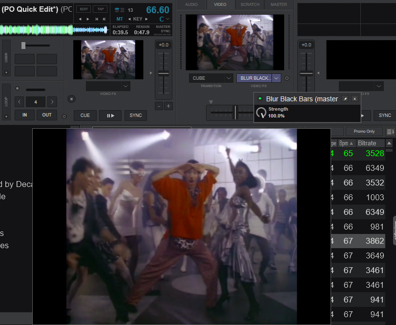

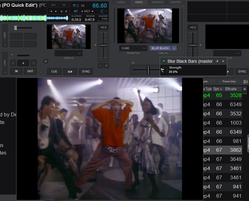

It doesn't seem to do anything. I'm using the latest version of Virtual DJ.
I am sharing my images of a video that obviously has black bars on the sides. The settings are 0%, 25%, and 100%.
0%
25%
100%
I'm guessing the script is outdated and won't work on the newer versions of Virtual DJ.

I refer you to my earlier post. Your videos are probably 16:9 with a 4:3 frame inside.
geposted Thu 07 Aug 25 @ 10:48 pm
If that's the case use Handbrake to re-encode them and remove the black bars.
