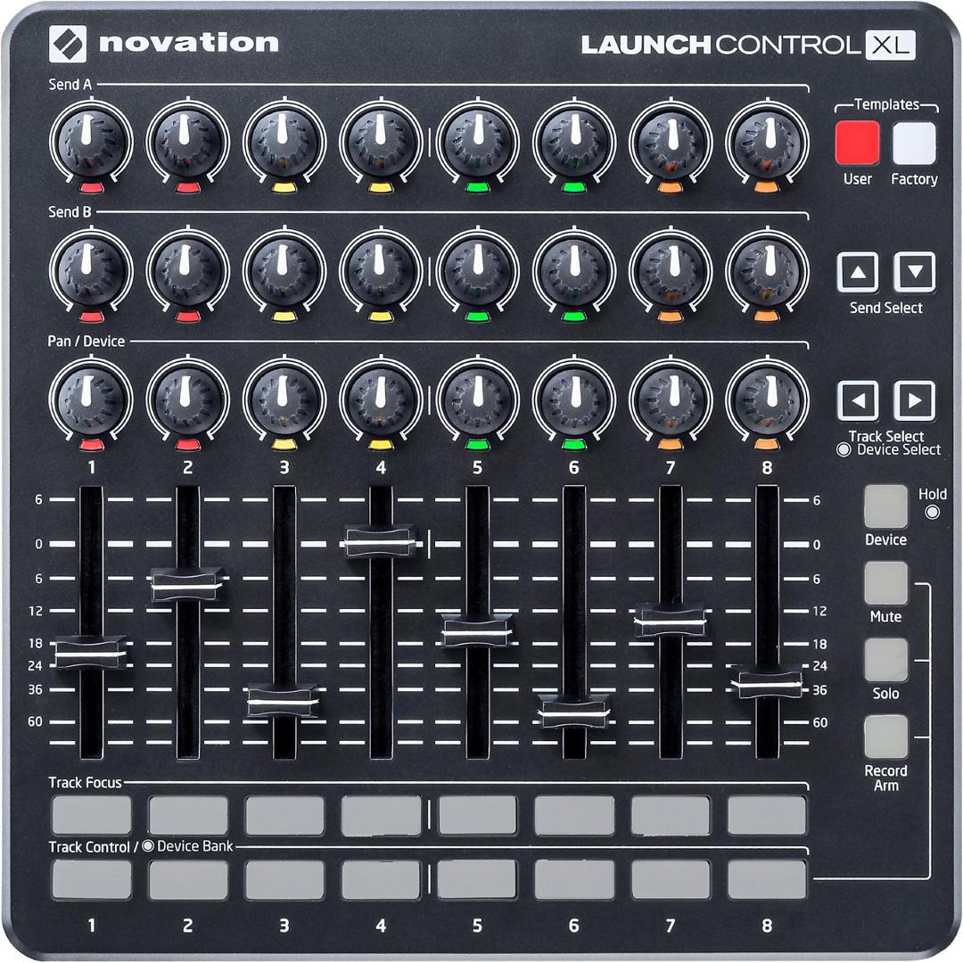

If anyone has figured out how to control the LEDS and lights on this device, please share your mapping and wisdom.
I have the device all mapped and working fine but still have not gotten control of LEDs and light.
Picture of device attached
Thanks
Thanks

You will not be able to control any LED unless you make a proper definition file https://virtualdj.com/wiki/ControllerDefinitionMIDI
Is this the MKII model ?

Thanks for the reply.
It is an MK2

Is this need for the definition specific to this controller?
I ask because I also use an old Akai APC Mini and I have no problem with the lights and LEDS on it and there is none of the parameters I am seeing in the file you linked for me.

A definition is required when the device is not officially supported (integrated into software)
We might get one in our hands. From what i see in the Programmer Guide of the device, it wont be easy to define this yourself.

Natively supported now in latest Public or Early Access Build - just have to run twice to get the silent update.
Should serve both MK1 and MK2 models.
Manual explaining functionality is coming soon.
The only issues i found was that there is no way to get the positions of the faders on startup, and the very limited amount of offered colors (just red, green, orange, yellow and a few shades of them - so not RGB)
Hope they add these on upcoming MK3
