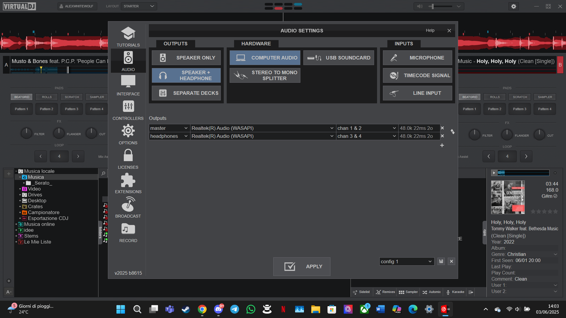

Can you post here a screenshot of your VirtualDJ Audio setup ?

Here, this is what it looks like
also yes, i made sure the master volume was 100% up
geposted Tue 03 Jun 25 @ 12:10 pm
I just noticed i took the screenshot after i lowered the volume back down a bit, but yes, i previously put it at max and still nothing
geposted Tue 03 Jun 25 @ 12:13 pm

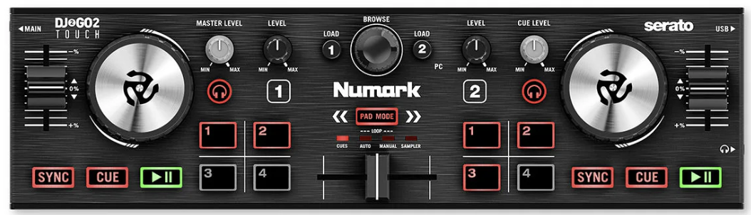

Ok, problem solved, i'm an idiot and i didn't notice there were extra volume knobs for both individual music, and they were both turned down by default. Now i can finally start mixing with this little thing.
geposted Tue 03 Jun 25 @ 1:34 pm
You mean the channel faders in VDJ? Otherwise, where were they?
geposted Tue 03 Jun 25 @ 2:01 pm
Probably the "level" knobs above the deck number.
geposted Tue 03 Jun 25 @ 2:04 pm
