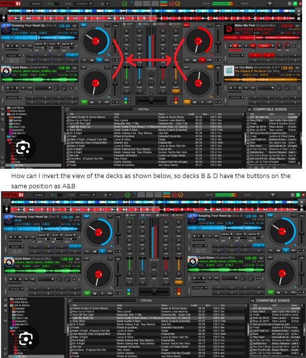

I am new to Virtual DJ. I see that the decks are opposite in the desktop view. Ho can I change the position of the controls of decks B&D to be the same as A&C? As shown in this picture (Not my best photoshop job)

          That would be a skin editing job. Not too difficult with experience, as the code for the two "left side" decks could be copied to (and replace) the code for the "right side" decks.
Maybe ask locodog to help you out...
