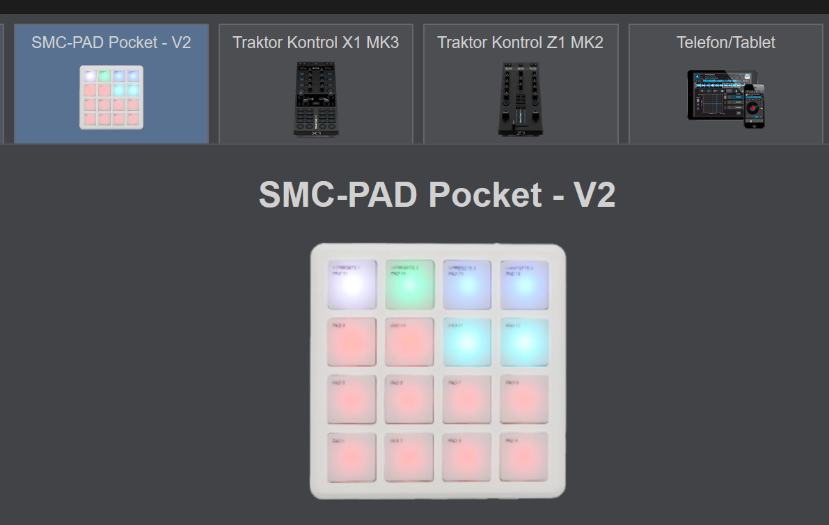

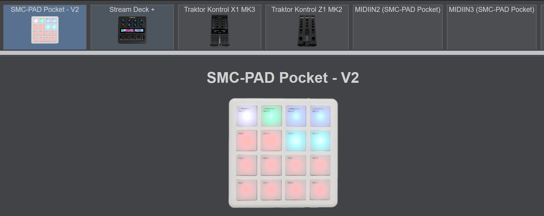

Hi All,
I use a SMC PAD Pocket with Virtual DJ. The SMC has 3 MIDI devices and they use the same "vid" and "pid". Therefore the 3 devices are showing up in VDJ.
I can separate the 3 devices via "drivername" in the Definition File and it looks like that now:
Is there a way to disable/hide MIDI devices in VDJ?

djdad wrote :
Not sure if the other 2 devices are useful in any way - at least within VDJ - but if by plugging this device, VDJ also creates some SIMPLE_MIDI_ mappings for those 2, you could also add to those 2 definitions ignore="true"
Many thanx,
to use
ignore="true"in definition files works :-)
The SMC Pad is only displayed once now, perfect!
geposted Mon 14 Jul 25 @ 9:25 pm

If anyone is interested. Here are my definition files that work for me.
For the two hidden SMC devices:
And here, the “real” SMC device:
