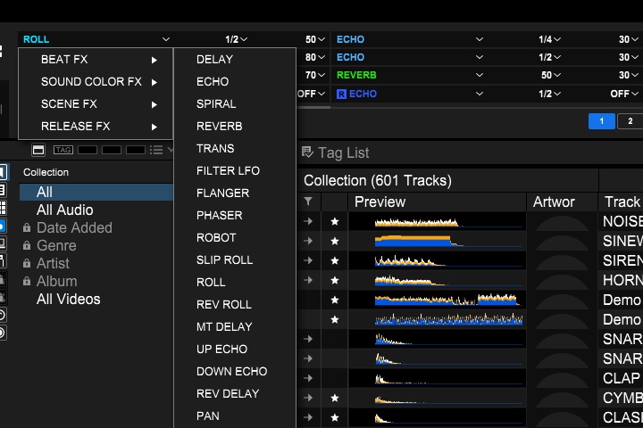

I understand were is lists in the Pad editor, however I and looking for a list of different effects and how to assign them to a specific pad for example:
In Rekordbox: there are drop downs for each pad:
Testing and comparing Rekordbox, Serato and VDJ...VDJ is packed with features and I am surprised it is so difficult to change the pad effects in VDJ, as well as the absence of any documentation on how to edit the pads, and what the syntax and coding that needs to be used...
