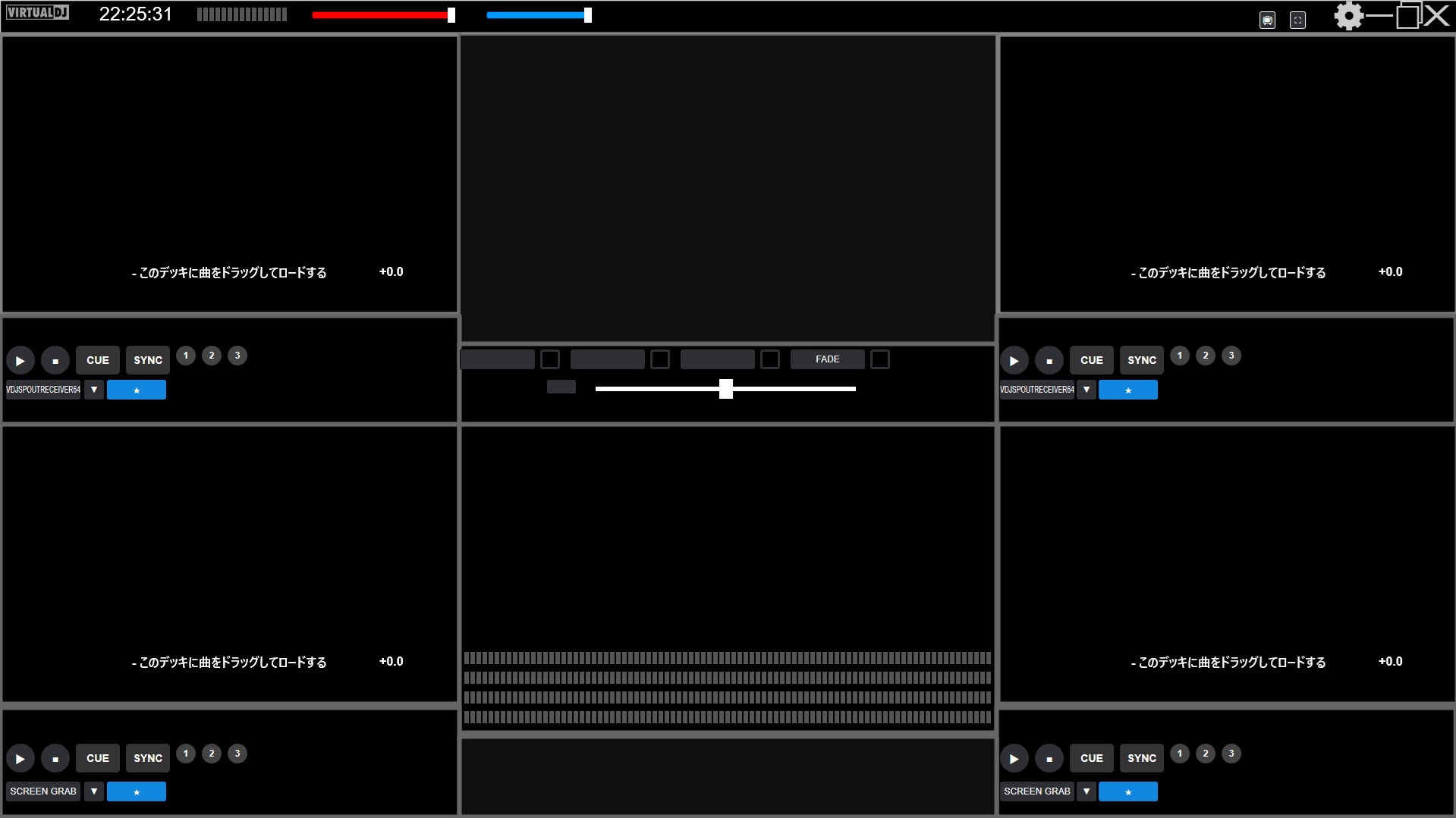

I'm currently creating a 4-channel video skin.
It's a very easy and simple skin, which is why I'm asking this question.
Sorry for asking another question, but when I change the window size from maximized, does the bottom get cut off?

Thank you.
The bottom is no longer cut off, but the items I place are now displayed out of alignment. Is there a solution?

There's nothing under the browser.
In fact, there's no browser at all.
geposted Mon 15 Sep 25 @ 12:14 pm

Now, is this a SKIN or skin window ?
What are you after ?
Can you post a screenshot of your skin without being resized ?
geposted Mon 15 Sep 25 @ 12:38 pm
It's unfinished, but it's a simple 4ch video skin like this.
geposted Mon 15 Sep 25 @ 1:27 pm
geposted Mon 15 Sep 25 @ 1:28 pm
