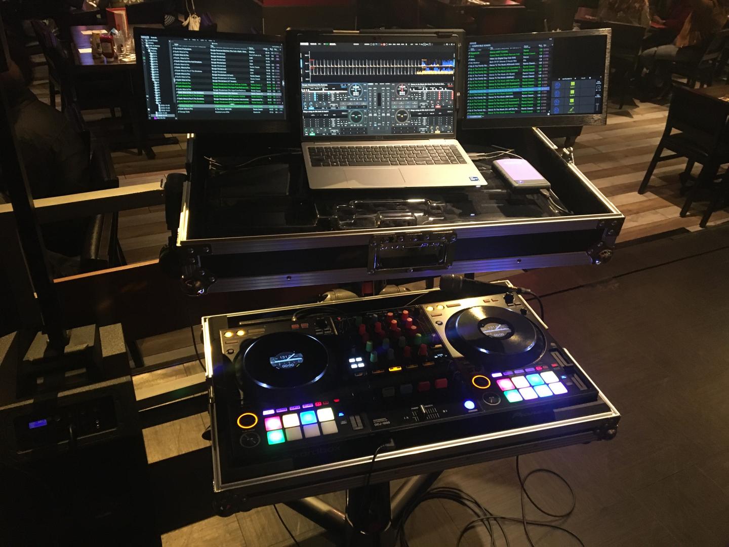

Hello everyone,
I am pretty interested to follow up on the subject of individual skin for each screen in a multiple screens setup.
I have my laptop with its monitor and a second monitor that is 9' touch
When i launch VDJ i will use the main skin, to sort think out and all, and on the second "mini" monitor i have a second skin more like what you have on the screen of different controller like the Prime 4, SCLive 4 OR Kontrol S8.
So that when i close my laptop i can focus on my controler and the mini monitor to get rid of the bigger one and save energy.
Is this something doable ?
Something like this : https://imgur.com/6XBG5z6 (needed two laptop for this example)

VirtualDJ handles multiple monitors and multiple wiindows just fine.
However, the default VirtualDJ skin has been designed for "single" monitor usage as that's what 99.999999999% of users use.
You can not load multiple skins (one per screen) at this point.
However there are custom skins that support "floating windows" that you can drag around and "assign" at any monitor your OS is capable of using.
So, you can use one custom skin, or if you wish (depending on your needs) to create your own / edit an existing one.
One other possibility (if you are going to "close the laptop screen" anyway) is to clone the 2 displays under your OS settings.
In this case both screens will show the same (as they are cloned) but it shouldn't matter as you're going to use only one of them anyways. Therefore you can load "any" single monitor/window skin and be done with it.

Thank you @PhantomDeejay
I use the last proposed workaround for now and switch back when needed.
