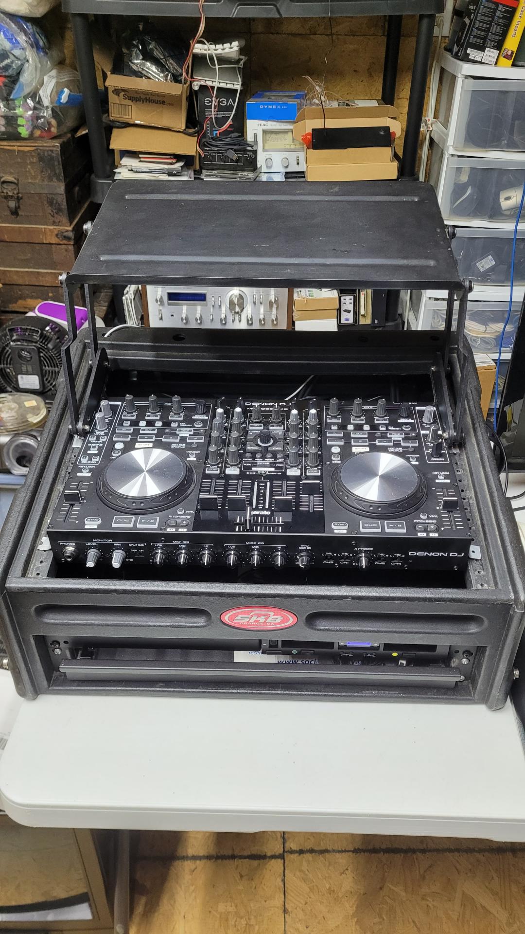

finally (after 10+ years), i am rebuilding my kit and using this controller over my beloved pcdj dac-3 (rip).
i don't use any vinyl or time controllers, just basic deck operations. both pc and mac.
what were the ideal settings in the audio setup and the use switch in the back?
and were there any mapping tweaks for this?
much appreciated.

I had to triple check the date this was posted.
I mean.. this post would make sense about 10 years ago or so, not today!
Today, MC6000MKII is a controller that's mostly retired from any users that had it and used it.
Anyway, MC6000MKII is a little less reliable than it's predecessor, MC6000
Other than that, there are not any special things you need to do.
Just make sure that you install the ASIO drivers for it.
The switch in the back and what it does is described here:
https://www.virtualdj.com/manuals/hardware/denon/mc6000mkii/advanced.html
For what you're after, just set it to REC OUT/MIC

thx :)
fig i'd finally start using it after i needed to replace the input switches (they go bad just by looking at them wrong).
did they ever make newer firmware updates and updates asio (Win 11 friendly) - and assuming, mac's just work?

No. One of the draw backs of owning a Denon device (especially of that era) is the lack of proper support, aka Driver and Firmware updates.
So, no, don't expect to find any real modern drivers for it.
As for MAC I think it "just works" but don't take that for granted either.

totally, get that. bought 10+ yrs back as it was the 'cool kid' in town, but could not fig a way to integrate (retro fit) into my 8 2 slant skb case - so continued to use my dac-3 and qspand mixer.
i have the lil dj2go2 for simple gigs, but since 2021 ish, i have been out of the loop. and the denon, has never been gigged, before or after i replaced the 4 switches that started to act up on their own. and really don't want to put too much more $ into the effort. i still have my original bose l1 classics :) but thanks for the comments and getting back. really appreciated it.
