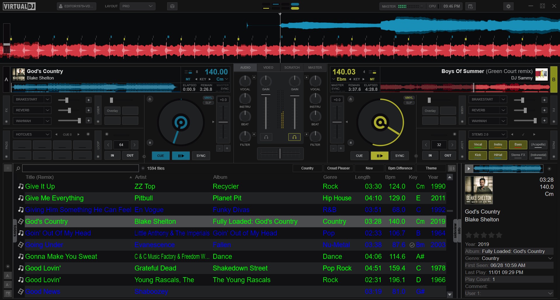

I The primary skin I use is Default-Pro in dark mode with Shapes waveforms, but there's one issue that's unique to certain people like me. I have some difficulty seeing low-contrast details, like Red on Black. I've always wanted to change the color of the right deck to something higher contrast, like Yellow. I copied and created Pro-Yellow.xml to change almost all the elements of the right deck to Yellow.
The elements that were missing were the VU meter and the waveforms. I corrected the VU meter by copying and modifying gfx-pro.png to create gfx-pro-yellow.png which took care of the VU meters, but the waveforms still elude me.
I've modified Pro-Yellow.xml as follows:
<define color="deckcolor" value="#ACAC2F" deck="right"/>
<define color="deckcolor" value="#ACAC2F" deck="2"/>
<define color="colorbass" value="#717A12" deck="2"/>
<define color="colormed" value="#888E1E" deck="2"/>
<define color="colorhigh" value="#ACAC2F" deck="2"/>
along with many other similar changes to the HEX color values of other elements within the skin. I just can't figure out where the color values for the Shapes waveforms are stored.
Any help would be appreciated!

https://www.virtualdj.com/forums/230926/VirtualDJ_Skins/VirtualDJ_2020_-_Additions_in_Skin_Engine.html
See Adion & mine's conversation starting 02/08/25 [that's August for people who write the date wrong]
