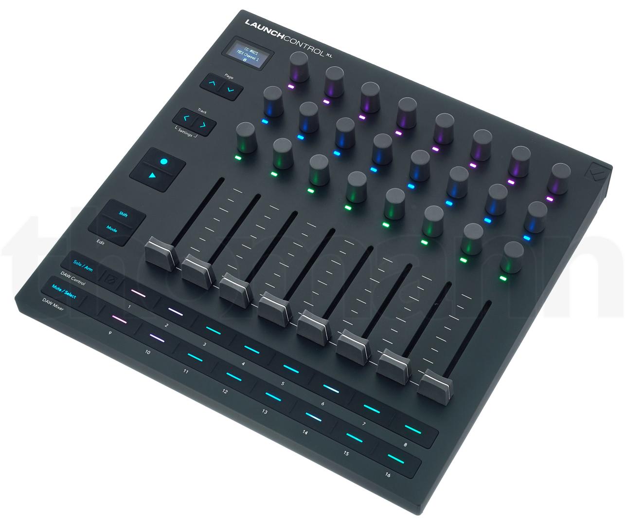

While waiting for a potential Launcontrol XL3 device defintion, I started building a simple one. I have trouble sending back info to the device.
Le's put an exemple. A 360 rotary encoder is used to control deck 1 gain.
In the definition file:
 <slider cc="0x0f" name="D1-GAIN" autoled="true" deck="1" zerorange="1" channel="2"/>
In the mapping file:
 <map value="D1-GAIN" action="deck 1 gain" />
If I use a midi app and send on Channel 3, the value 64 with CC 0x0f, both the LED intensity and the actual value of the pot will be modified correctly.
I didn't manage to achieve the same thing within VDJ. I tought autoled would generate a LED_D1-GAIN that I could use but I don't see it. I also don't know what actions I should use with that key to to send the proper midi message.
Can someone advise me?
Thanks!
Thanks.
I figured what you meant but I'm still stuck. I have two questions.
1-The LCXL3 has 4 devices: (in+out) normal MIDI mode and (in+out) for DAW MIDI mode. I figured that VDJ input is on port 1 and VDJ output should be on port 2 for normal MIDI mode. VDJ discovers the 4 devices. As we speak, data is well recieved on port 1, but I cannot send on port 2. Do I need to prepare a second definition file? Should the vid or pid be different for VDJ to figure out which port is which?
<device name="LCXL3" author="Yan Duval" description="Novation Launch Control XL3" version="2026" type="MIDI" vid="0x1235" pid="0x0148" >
2-Let's pretend that I want to use the following definition element but I want to vary the value.
<led cc = "0x4A" value = "0x5C" ccoff = "0x4A" zero = "0x2C" sendstatic = "true" name = "LED_EFX1_BTN" default = "EFX1_BTN" deck = "1" channel = "0" />
Is it ok to suppose that the definition file must be static, or can use variables but only once at startup?
To change the value, is it valid to do this in the mapper?
<map value="LED_EFX1_BTN" query="deck 1 eq_high_freq" />
Yes (but note that led is on/off, so your example of mapping it to eq_high_freq doesn't make much sense)
Also you don't need "deck 1" in your script, since you already define in your definition that this element is for deck 1.

Ok great, so if my single led can vary in intensity, I should use the bar element instead?
Yes
Great, thanks!
And for my first question? Should I do a single definition file and create 4 mappings (out-MIDI, in-MIDI, out-DAW and in-DAW) and assign them to the respective controllers shown in this image?
They are not described better but I can find which is which by trial and error.

To answer Phantom:
1-First use is to add extra buttons to my FLX4. The initial Lauchcontrol Template 1 is probably that.
2-Second would be to facilitate the use of deck 3 and 4
3rd is to do use it as a small dj controller.
I can for sure give more details but I guess it would be better to exchange a Word document or something similar. Is it of interest?

The Launchcontrol XL3 looks great.
I don't know if I could justify a purchase, or realestate, as I currently have a Midi Fighter Twister and Launchpads for needed knobs and buttons.
For use would maybe like, one bank to allow control of all the FX 3 slots and each of their parameters, with the strength using the fader, plus any additional knobs for maybe 2 or 3 extra CFX knobs (effect_colorfx 1-4)
Another maybe useful bank, to have deck 1, and deck 2 being knob rows 2 and 3, respectively, with the knobs being the stems (maybe EZ-Remix), and the Frequency EQs (Hi, Med, Lo) and the faders below each of the Stems would be used as Stems crossfaders, to Crossfade the respective stem above it, or crossfade the Frequency EQ, above it between decks 1 and 2.
(and fill in any unused knobs with CFX (effect_colorfx 1-4).
And use the pads for, Jumps, and setting loops, maybe on each of banks, and maybe a few instant filters (quicksearchs), and some gotofolder and gotolastfolder pads, for quick navigation.)
I would be interested in feedback for use as a DJ controller. I have peeked at the reviews and some report the knobs at times are bit stiff.
