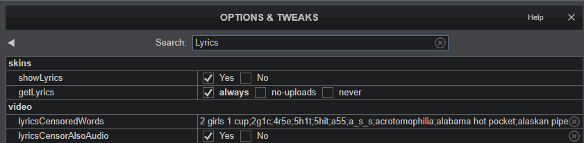

Each word needs to be separated by a comma, like, this, very, naughty, words, go, here
