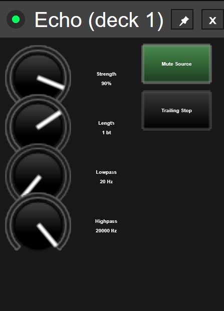

Legacy echo:

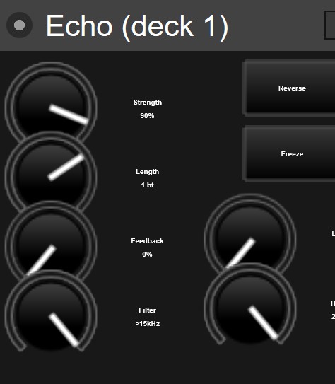

New Echo:

Legacy echo:
New Echo:

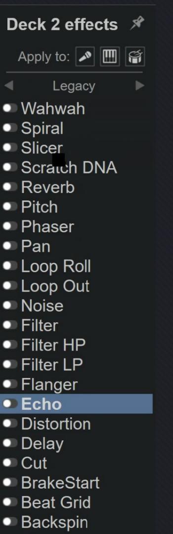

Did you select the "legacy" effect list on slot 3?
geposted Tue 09 Dec 25 @ 6:46 am
Thanks for the quick reply.
yes have selected the Legacy "echo" for slot 3.

Note: Parameters for the legacy echo are set as pictured above.

Echo works fine here.
Can you please close VirtualDJ, open VirtualDJ folder, then plugins64 folder and delete any "native_Echo" ini files present ?
Or at least try to set the settings as per the pic below:

IIDEEJAYII wrote :
New Echo:
New Echo:
I don't know how you end up with such settings, but yes, they are completely messed..
1) Feedback (slider 3) should be more than 0% in order to sustain some kind of echo
2) Filter (slider 4) should be at the middle. Currently it sits at full highpass (as resonant filter, not to be confused with lowpass and highpass sliders 5 & 6)
Try this on a custom button in order to reset the effect without the need to delete the ini files
effect_select 3 'echo' & effect_slider_reset 3 3 & effect_slider_reset 3 4 & effect_slider_reset 3 5 & effect_slider_reset 3 6 & effect_active 3
geposted Tue 09 Dec 25 @ 7:51 pm
Thanks Phantom!
Appears that my scripting for the echo parameter sliders (for the Legacy echo) made the New Echo not work, by setting slider 4 to 100% (since w legacy echo slider 4 was Highpass and wanted 100% ) and New Echo slider 4 is Filter which if set to 100% cuts everything. Yes New Echo needs to be at 50% (OFF) to work.
Thanks for the catch.

effect_list 3 'Legacy' & effect_select 3 'echo' & effect_active 3
Again huge thanks for the assistance!!!
PS the only minor issue of adding the effect_list 3 'Legacy' to every FX script, is, since the FX is called by scripts, and if diff FX effects are scripted quickly, (faster then 2 sec) then all one may see is "Legacy" displayed in slot 3, instead of the actual FX active at the moment from the pads/buttons.
It is more satisfying to get instant feedback as to which FX is active, without a 2 sec delay.
(just a personal feeling)
Will attempt to add effect_list 3 'Legacy' only when needed.
