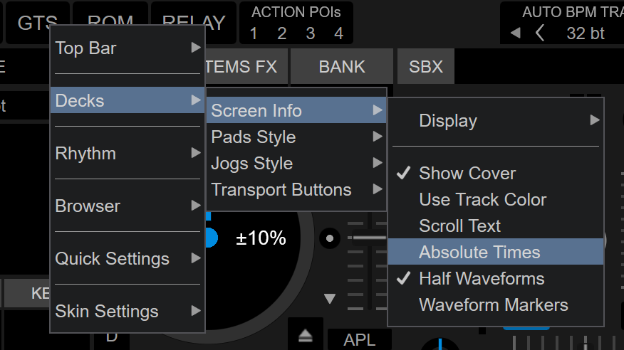

It is possible to show the "non pitch adjusted" time value.
The bad news are that this can be done only by editing the skin.
get_time 'remain' 'absolute'
geposted Mon 29 Dec 25 @ 11:32 pm
You can also try to use this skin:
https://virtualdj.com/plugins/?addonid=81906
It has an option to use "Absolute" times from version 1.0.41 onwards
