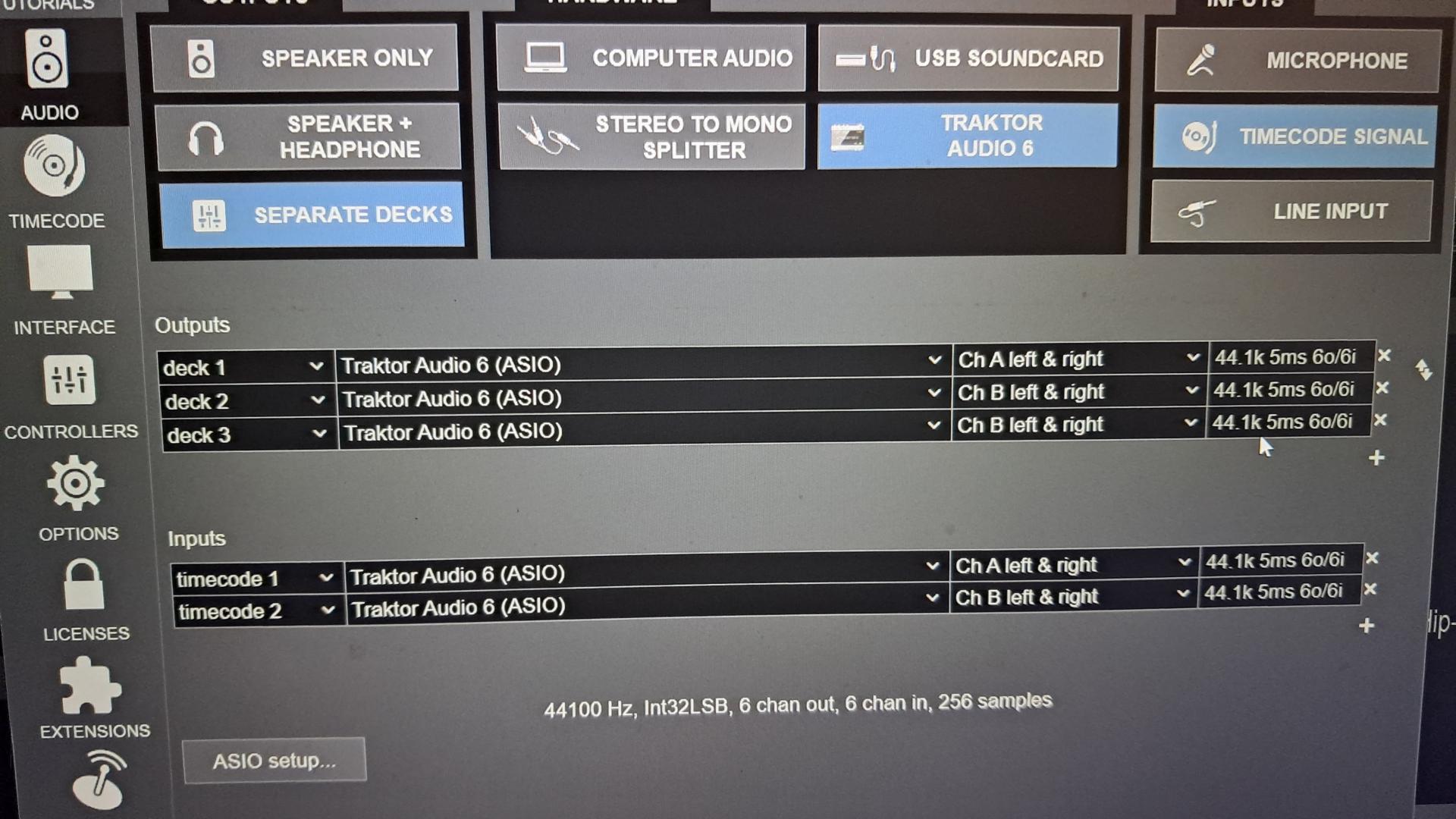

Guys... everything is working but I cannot record the djset...The record button is not clickable.. I believe its an audio setup issue...
Here what I see in the audio config.

That's normal. If you're using an external mixer setup then the internal mixer is not being used - so there's no "master output" to record from.

Actually I connected the mixer Rec out two RCA to the sound card Rec IN adding a new input channel on virtualdj audio configuration and it works...
Thanks guys!
Thanks guys!
