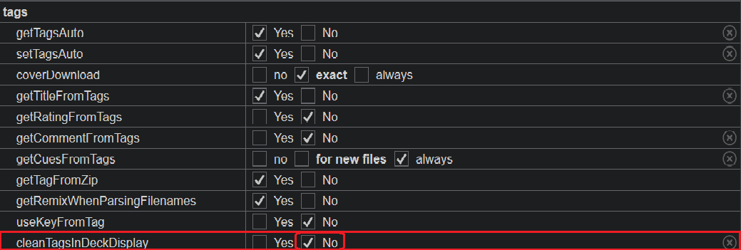

As for point 1, I will clarify exactly what I mean. When you load a track onto the right or left deck in software Virtual DJ on the Pioneer DJ XDJ-RX3, the CUE button lights up automatically. As in the picture below.
And I have the following programme settings.
My question is as follows. How to prevent the CUE button from automatically turning on when loading to the left or right deck in Virtual DJ?

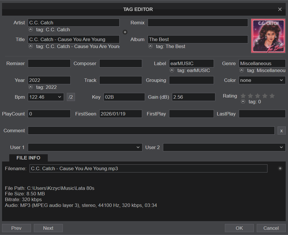

As for point 2, I will clarify exactly what I mean. I want the artist and song title to be listed in the bar below. And not just the title of the song.

Thanks for clarifying because when you first posted, I assumed you were referring to the cue on the decks, not the mixer. In the settings, change autoHeadphones to 'no'.

About 1:
As groovindj said, change "autoHeadphones" setting to "no"

The controller (XDJ-RX3) screen is designed to show TRACK'S TITLE
Not a combo of Artist - Title.
So, VirtualDJ does exactly that. It sends the info of the "TITLE" field on the screen.
It CANNOT send "Artist - Title" on the main screen shown on your screenshot because the same data are used for track info panel.
Now, I don't know what you're trying to do, but as long as you put "something" on the Title field of the Tag Editor, it should be shown on XDJ-RX3 main display.
PS: You cannot have a track without artist and without title in VirtualDJ. If you leave both fields blank then the filename will get used.
PS2: When a file has no tags, VirtualDJ always parses the filename as Artist - Title (Remix)

Unfortunately, I disagree with you here. I spent about 5 hours with my laptop at the console to solve this problem. And I managed to solve this problem. First, I will show you how I have all the tags made with my songs.
The only correct solution is to select the option I have marked in red.
Other options didn't help.
What problem ?
What exact problem did you try to solve ?
As I told you, the XDJ-RX3 screen is supposed to show the TITLE field on it's main screen.
Putting "Artist - Title" on the TITLE field on the Tag Editor is a "hack" not a solution.
Then this "hack" may cause other issues that may or may not need to use other settings to solve.
So, what exactly was the problem ?
If you absolutely want to see "Artist - Title" on XDJ-RX3 main screen, then you should remap the corresponding key.. Not "hack" your entire database.
So, if you absolutely need/want/must see "Artist - Title" on XDJ-RX3 main screen, then remap TEXT_TITLE key of your mapper to load_pulse 50ms ? get_artist_title : get_text ' '
The drawback is that now on other parts of the screen you'll see "Artist" twice.
If you open the info tab of the XDJ-RX3 screen now you'll see
Artist: C.C. Catch
Title: C.C. Catch - Cause you are young.
But I guess that's ok with you if you're willing to do this on your entire database as shown by the screenshot of your Tag Editor.
