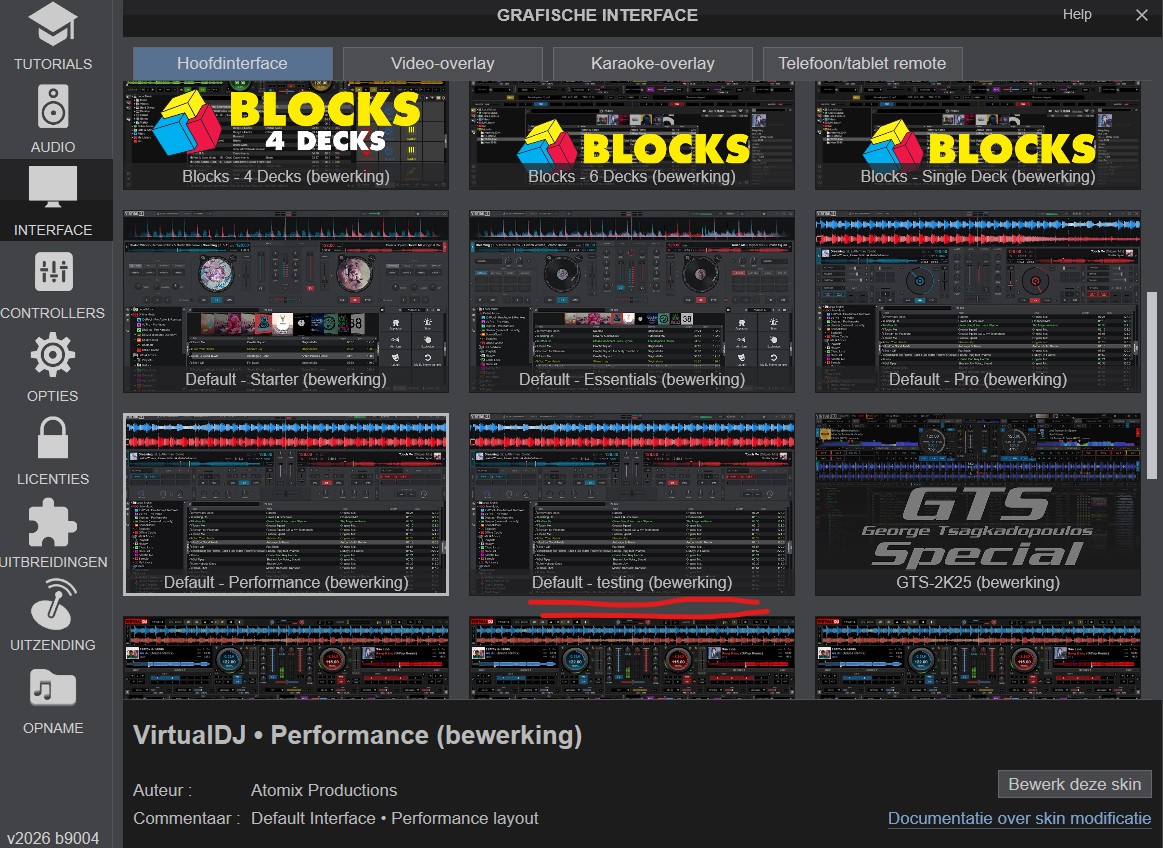

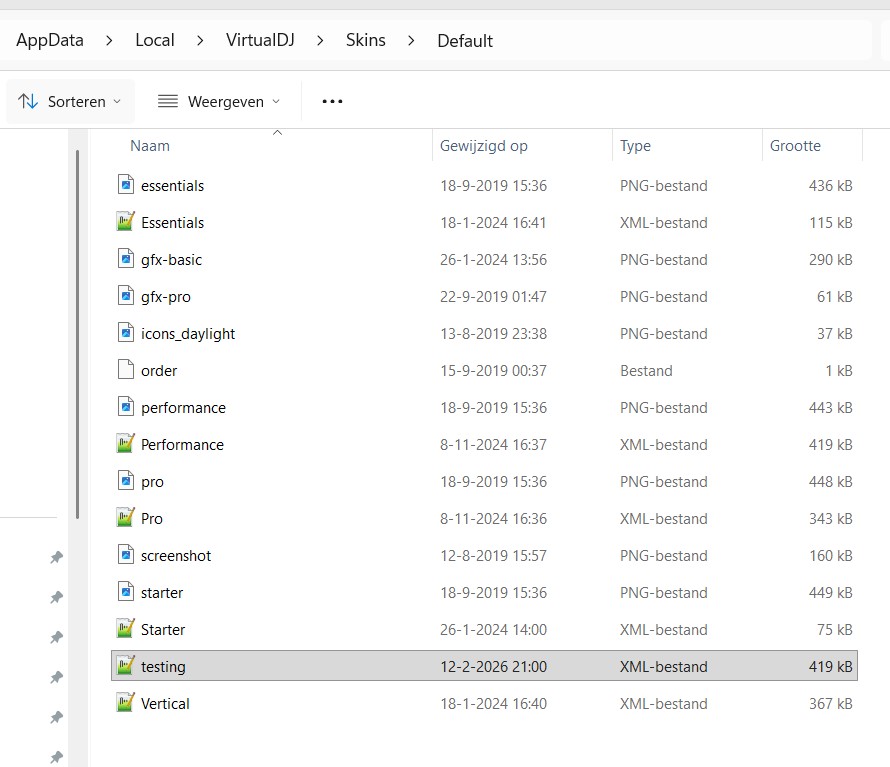

Is there a way to switch quick between a skin that you are designing, to see in a fast way
wat your XML line of code does in the skin. I prefer it to do with a shortcut.
In my case, i have unpacked the Default virtual skin. I save the modifing skin under the name "testing".
Below is my folder structure and what i seen in virtual DJ.
mvg,
Marcel
mvg,
Marcel

Hi all,
Its indeed I want to switch to or load to the default skin with a shortcut. The reason for this if you have loaded your development skin, it could be that you dont have the right skin buttons on you screen to switch back or go to your settings screens (just because I am not that far with it)
So my underlying question how does vdj reconize/reference the skin. The default skin is in a zip file, the development skin is in an uncompressed folder. What does work and what don’t?
Gr Marcel
Gr Marcel

settings "controllers"
settings "options"
settings "interface"
load_skin "Default/:testing"
the / means it uses a unzipped folder
settings "options"
geposted Fri 13 Feb 26 @ 9:58 am
