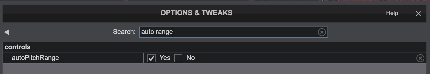

The option is to set Auto Sync on Load (or use the mentioned verb), and probably also set the setting autoBPMRange to true if you are planning to do wide range beatmatching.
If your BPM is actually correct for each song and you sync one to another, then your grids should match up. If your songs don't sound synced, that means your grid in one or both songs is placed incorrectly.

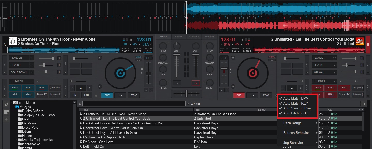

Thank you for your reply - this isn't working correctly. Please see the image below.

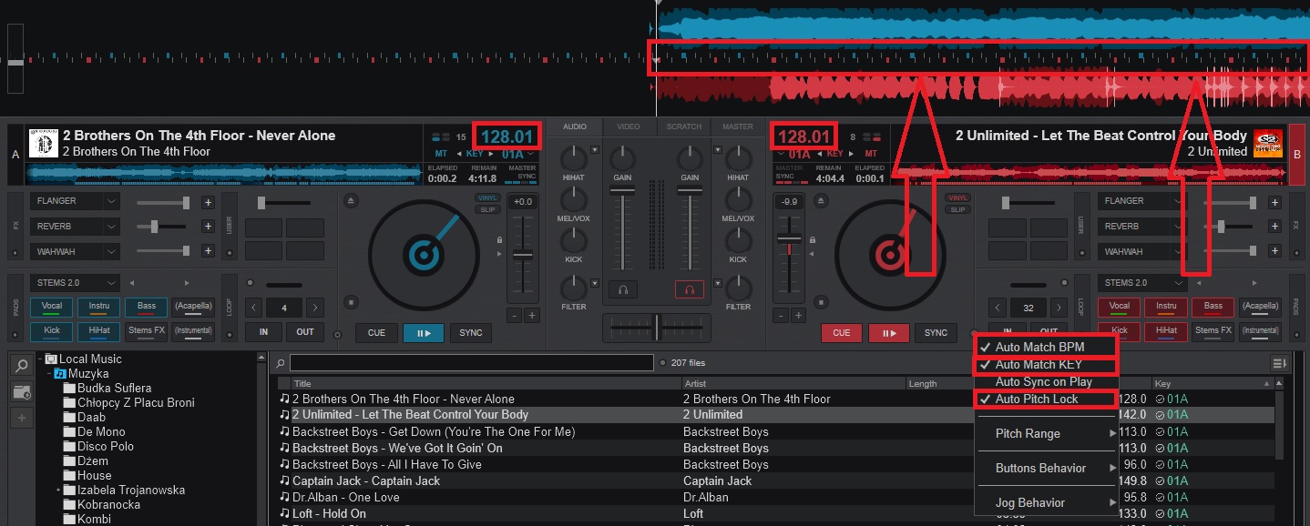

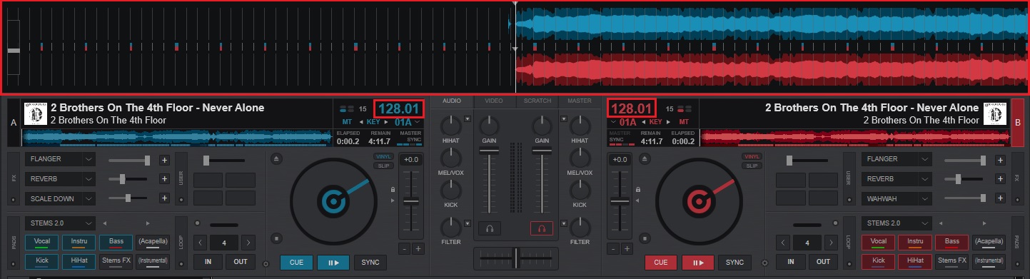

Thank you for your answer - none of the options have helped so far. I would like it to look like the image below.
Of course, I write to make this happen with various songs.

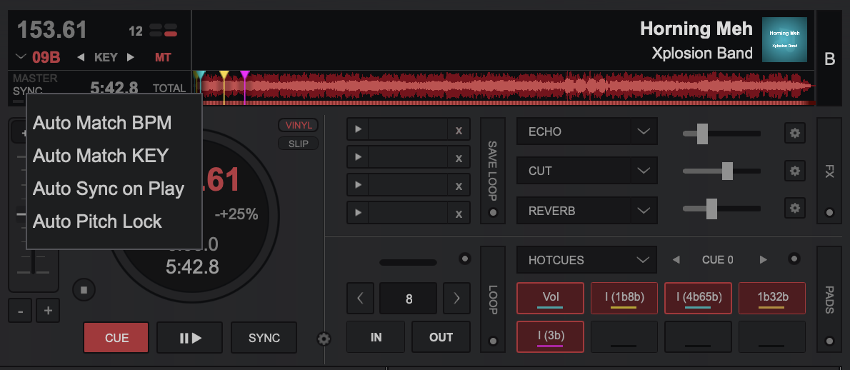

Enable Auto Sync on Play.

Thank you for your answer - nothing helped either. Please look below.
I would like it to work like in the link below.
