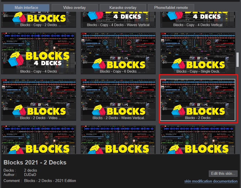

I'm asking you to use the default skin to do this task because I'm not sure if the skin you're using supports pad page assignment or not. From your screenshot I can see that you use a custom skin, but I can't tell which one.

I have attempt this and still seem do nothing.
The skin I was use Blocks - 2 Decks
Still when touch button Pad Mode on DDJ-800 , it is not change on VDJ
when change on VDJ it is not change on DDJ-800
I test with skins :: Default - Performance , Default - Pro , Default - Essentials , Default - Starter
