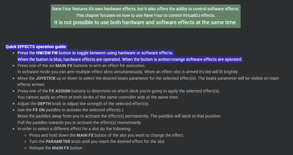

Please read:
https://www.virtualdj.com/manuals/hardware/rane/four/layout/mixer.html#effects
Rane Four is capable of doing both Hardware and Software Effects.
geposted Mon 09 Mar 26 @ 9:39 pm

geposted Wed 11 Mar 26 @ 6:54 pm
I still can't understand what's not working for you.
Please stop going around the table, and describe with clear steps 1,2,3 what you're doing, what you expect to happen, and what's happening.
The only limitation the device really has, when it comes to software effects, is that for the most part they have to be triggered by the controller itself, and not the GUI, because the device has effect send/return channels.
Also, in order to be sure that software effects are working as they should, you should use the controller to select them and adjust their parameters. That's because the controller can control up to six effect slots that have to be common among all decks.
The factory default mapping ensures that when you select an effect on a given slot (let's say slot 4) by using the controller, it gets copied on all 4 decks so that they all can trigger it.
These "quirks" are because of the way the device is designed to work.
However they should not be any kind of limitation to user experience.
Now, again, the unit has it's own hardware effects (the HX/SW FX button is blue)
Effects like Echo Out, Rider, STTR Out and others. Those effects are hardware and work exactly the same regardless the software you're using.
Also both Serato and VirtualDJ pass the BPM of the deck on the unit so that it has precise timing for beat aware effects.
Then, there are software effects (the HW/SW FX button is orange)
In this mode the six effect buttons "ARM" one of the first 6 effect slots in VirtualDJ GUI.
And then the paddles turn on/off the effects of these slots.
When in software mode, the first FX button, "arms" the first FX Slot on VirtualDJ GUI.
The second FX button arms the second FX slot, e.t.c.
Same as with hardware effects, the FX buttons on the "right" deck are not there to arm slots for the right deck. They are there to arm effect slots 4, 5 and 6.
By default Effect slots 4, 5 and 6 are not visible on VirtualDJ GUI but you can click on the effects panel to make the 6 slots view visible on the PRO layout.
So, let's say that you want to use SOFTWARE ECHO effect which is loaded on FX slot 1 on all decks to apply an echo on deck 2.
What you do is this:
1. Make sure the HW/SW FX button is orange.
2. Press the first of the 6 effect buttons (that's located on top left of the left deck area) so that it turns on.
3. Make sure the FX Assign buttons are showing the correct decks set (1 VS 3 and 2 VS 4) Here you want CH2 to be on.
4. Use the right FX paddle
Now if you want to use the hardware effects (like Riser) the procedure is exactly the same.
Only that HW/SW FX button has to be blue. And you need to press the 4th effect button (1st fx button on the right deck side) assuming that you have not modified the factory default fx memories of the unit.
So..
Please try to explain what you're trying to do..
So..

If the button is blue, then hardware effects are applied. Period.
The hardware effects are not visible on VirtualDJ GUI. They don't have too. The controller doesn't care. If fact they are applied even if a DJ software and/or a computer is not connected.
The hardware effects are visible on the central screen of Rane Four. You have 6 slots and you can leave them at their default effects, or change them and select a different one from those that the unit offers.
This selection of hardware effects cannot be done via software. This selection is done from the controller itself. I'm not in front of the controller right now but IIRC it's similar to how it's done in software mode.
You hold down the effect slot button you wish to change, and then you turn the FX SELECT knob. Once you find a new effect that you like, press the FX SELECT knob down to select it.
All the information I provided here is more or less present on the manual page I gave you at the beggining.
In fact:
I highlighted the first bullet because it tells you exactly that: How to toggle between hardware and software effects, and that the color of the led shows you the mode you're operating.
PS: The procedure to activate hardware effects is EXACTLY the same with the software effects.
You press one of the 6 effect slot buttons to select an effect and then you use the paddles. Just in case that's what you're asking ?
In fact:

PHANTOMDEEJAY: I understand perfectly what you are telling me about the controller and the slots (blue buttons), orange-blue hw/sw/fx button and etc. although I did forget about that. I understand that the effects can be changed with parameter changes on the controller using the toggle lever and the FX knob. I also understand that those will not be seen (not visible) on the GUI and only on the RANE central screen. Maybe it is you that doesn't understand what I was saying. They DID NOT WORK on ANY virtual skin I tried. Or with VDJ....period. I can't tell you why they DID NOT work, I just know they didn't. No matter what I tried. Therefore, I thought it was a mapping issue and I asked about mapping and if it was supported at all. But as of last night, I re-purchased a pro license, downloaded the newest version of VDJ, and I am now on the way to where I want to be concerning the effects. I have all of the slots working on VDJ (with paddles), along with stems and my sampler volume working as well. I was only asking about certain skins to see if one was better than the other to use with the RANE. Thanks again, your insights have been very helpful.

You're talking to a dev of the software who most likely did the mapping for the controller in question, so I'm pretty sure he knows what he's talking about.
You keep focusing on the skin showing functionality of what the control is doing. That's actually not required - skins don't produce the audio or do the mixing. If the skin shows the control manipulation, that's a bonus but not a requirement.
I'm almost certain that the effect selection and pad toggle levers shows the enabling/disabling of the desired effect on the skin.
I'm also sure that the sampler volume on the skin can follow a sampler volume knob, because it happens for my DJM-S11 and DDJ-1000. If it doesn't happen for the Rane Four it's either the knob doesn't send MIDI (which I doubt since I saw an entry for it and you said you see activity for it) or you changed the mapping to cause it to not show differences.
At this point, you need to explain exactly what it is you are trying to do/see when the action is done, and @PhantomDeejay and others on the forum will help guide you on how to do it (if it makes sense).

My apologies if my last message was taken in the wrong way. I never said PHANTOMDEEJAY didn't know what he was talking about as his messages to me are very technical. What I said is (quote), "Maybe it is you that doesn't understand what I was saying". Meaning he didn't understand what I was trying to do, or maybe I was not saying what I wanted in the correct way. I do not know the technical verbiage of the software and that may be why I seem confused.
Here are the 1,2,3's of what I was trying to do, what I thought, and what is updated.
1) I wanted all of my effects and sampler volume knob to work with VDJ. I was asking if there was a mapping for that to happen as none of them worked with VDJ. I don't know why but they just DID NOT work. I forgot about the hw/sf/fx button on the controller that was mentioned as well. The update is they are all working now. slots 1 -6 (effects) are working but I need to tweek them for both sides. I will go back and re-read what was sent to me concerning this.
2) I was asking if there was a certain skin (maybe one built specifically for the RANE FOUR) to use with the controller. I wanted to see functioning buttons and knobs because I thought that was how the effects were controlled, through the skin. I see now that the skin doesn't matter when it comes to function. They are only a GUI and some will show different buttons and/or pads. The update is that I found one I feel suites my needs.
3) I wanted my sampler level volume to work with VDJ. It was not working at the time and I was asking for mapping for that as well. Although you say showing functionality is not required, as with the effects buttons, it felt good to see it/them move at the same time I move the controller knobs. I re-read the documentation sent to me by PHANTOMDEEJAY. Since then, I found a skin with a controller knob and mapped it using the eye dropper. The update is that it is now working the way I want it to work. It shows moving when I move the controller knob.
As i have stated in my last message, I have everything pretty much working along with the paddles too. Again, I don't mean to make this any harder or complicated than what it is so I apologize for any misunderstandings.
