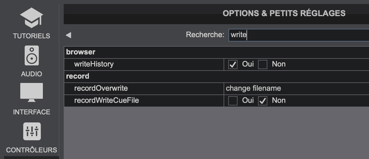

setting writeHistory
for practice sessions you could turn that off

sure the first is a setting, just go into options and type "write"

"sure the first is a setting, just go into options and type "write""
I've just typed "write". That's it for the first step ? I don't change any setting or parameter ?
geposted Wed 18 Mar 26 @ 11:09 am
oui - it will write history /last played
non - it won't.
non - it won't.

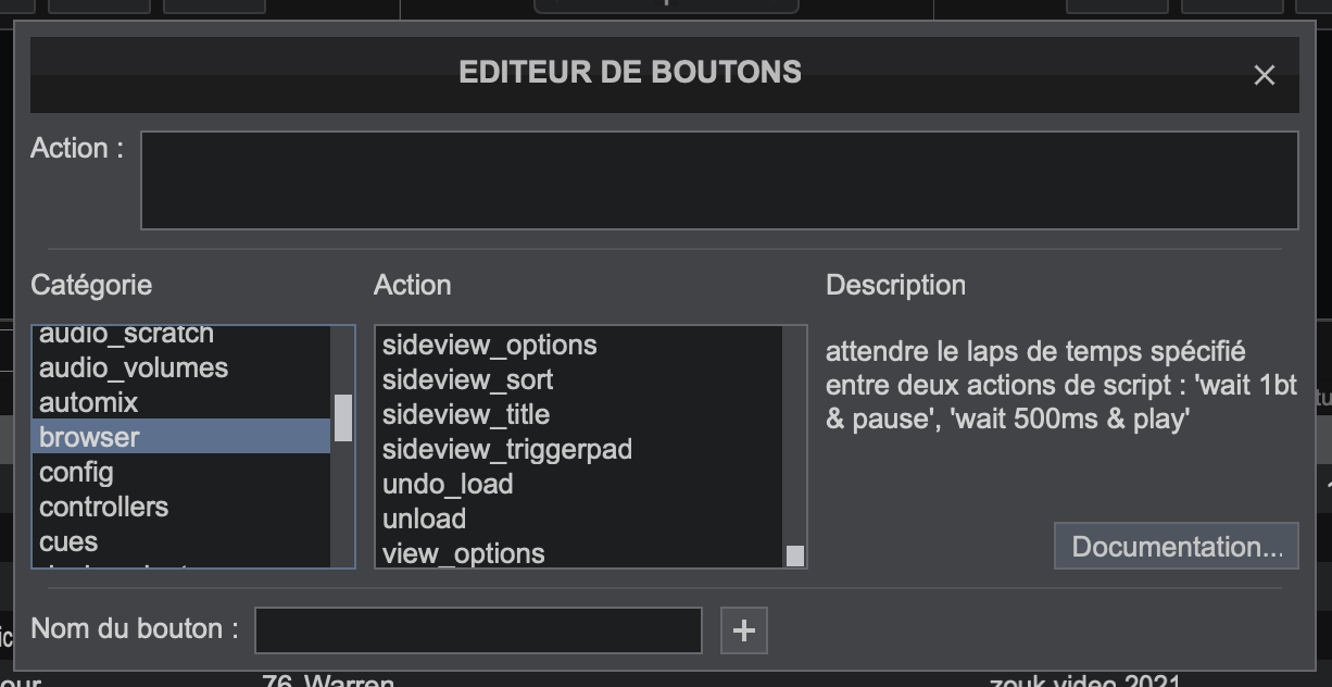

Now is it me or no Custom button can be used for this action ?

Just enter
The button will switch writeHistory on/off and change the button colour too.
setting "writeHistory"to the Action: area
