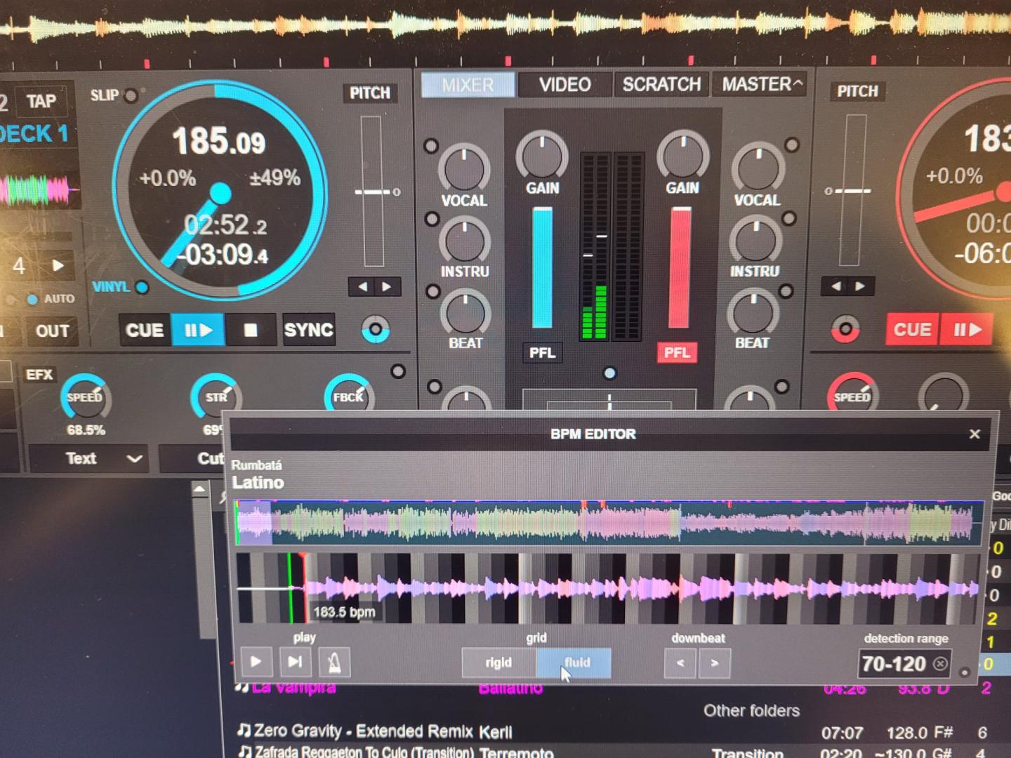

slight issue here, fluid range is set to 70-120 but song still is up at 180, 190
geposted Fri 03 Apr 26 @ 6:57 pm
Comes in at 91.76 for me (range 60-180). What build are you on?

did you rescan?
geposted Fri 03 Apr 26 @ 7:02 pm
nevermind, i just had to reanalize it. it was previously analized without the limit
I thought just flicking back and forth between fluid would do it.
thanks

Whats the meaning with the fluid bpm?
geposted Fri 03 Apr 26 @ 8:52 pm
Manual is here -> https://www.virtualdj.com/manuals/virtualdj/editors/bpmeditor.html#fluid
