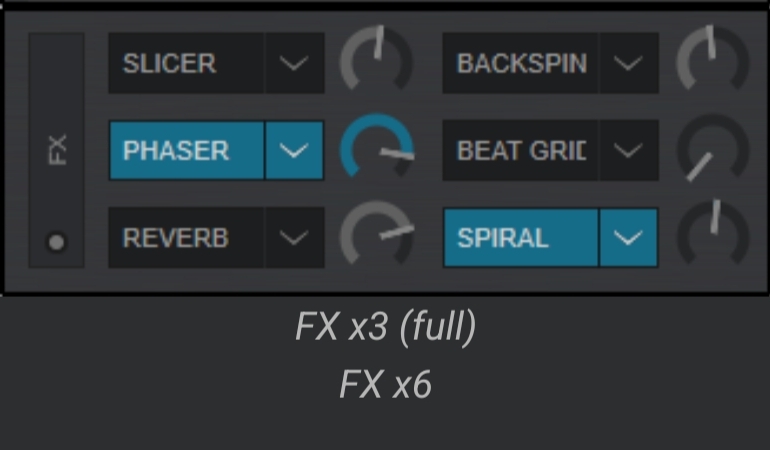

Based on the video, it proves you didn't fully comprehend what we said/didn't probably read the effects section of the manual.
In VirtualDJ, each deck has its own effects module (unlike Serato, which has 2 universal effects modules shared amongst all decks, which can host up to 6 effects - 3 per module). What you showed, in all cases, was the 3 effect layout (i.e. each deck was showing its 1st three effects). The effects rack also switches to show the first 3 effects of the deck in question that is being shown (it can switch, for instance, on deck inversion when selecting decks 3 and 4 from a 4 deck controller).
That means, in all deck cases, based on the setup you showed, you are just seeing the 1st three effects for each deck.
If you were actually viewing all 6 effects, it would look like this (this was taken from the same manual page provided to you):
And that is only (currently) available if you switch to the Pro layout (or use a 3rd party skin that shows all 6 in a rack from the Extensions), enable and then select the 6 effect layout for the deck.
What we are saying is, the right side of the controller's FX1, FX2 and FX3 will enable/arm the slots 4, 5 and 6 for all decks in question, and the paddle will activate those slots for the deck in question (the paddles are deck specific).

Finally, something useful:
"And that is only (currently) available if you switch to the Pro layout (or use a 3rd party skin that shows all 6 in a rack from the Extensions), enable and then select the 6 effect layout for the deck."
I mentioned several times that I'm using the Performance layout with the Effect rack visable. The advanced Controls / Effects manual doesn't address this layout at all. There is nothing there regarding the Performance layout to read or comprehend.
For anyone else who runs into this issue, use the Pro layout, toggle the Effects view to FX6. This is the only way to see all six effect options per deck using any of the default layouts. This option doesn't exist in the Performance layout.
