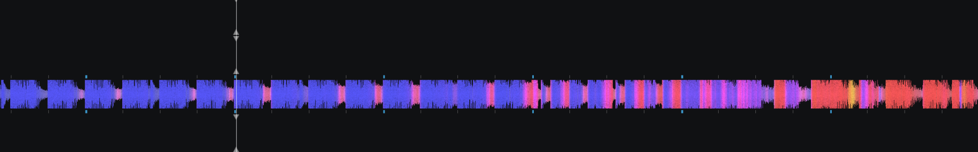

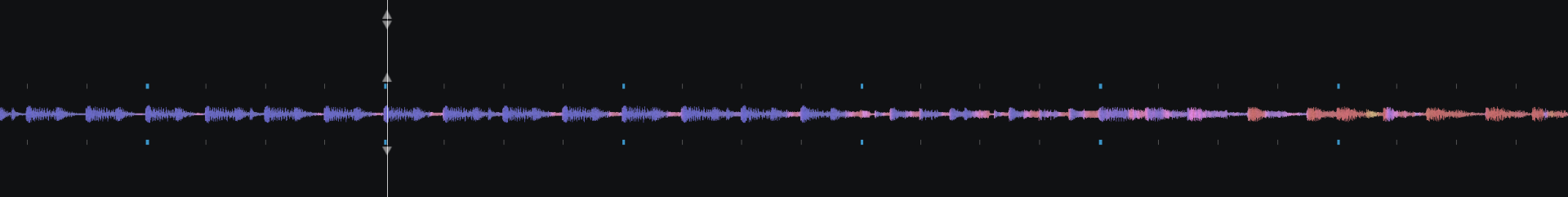

thx djdad for your kind response
See the photos i attached, is shows the exact issue i mean

Posting.2 images doesn’t really help.
What exactly are we looking at and what did you change to get the difference?

That's gain change not eq, and is hardcoded - can't be changed.

No. And it's on purpose. So that when you increase gain, you see what you're doing at your audio and how you compress everything and bring it close to distortion.
Generally speaking, you need to set the zerodb setting correctly so that you RARELY have to use the gain knobs (with autogian enabled of course)
