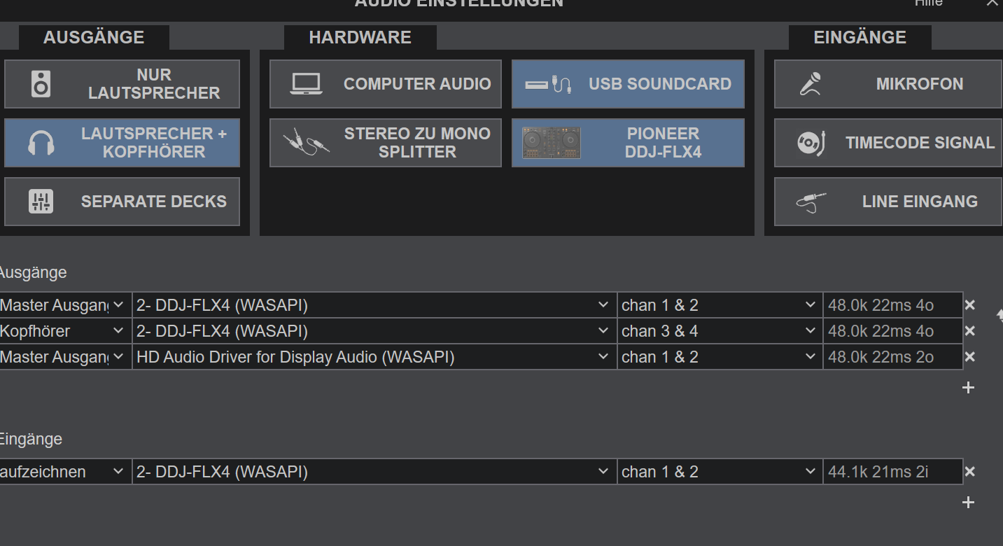

I am a new user (coming from rekordbox) and I have troubles getting my flx 4 to work properly.
1. there's no audio on the headphones. I have cue activated, checked all the volume dials, but still nothing. I attached an image of the audio settings. https://imgur.com/a/m7Z2fX7

Your audio config should look exactly as it does here:
https://virtualdj.com/manuals/hardware/pioneer/ddjflx4/setup.html
Specifically, the USB soundcard addition you made should be removed (the board has its own soundcard built in).

Thing, is, if I put it like in the link, there's no sound at all (my speakers are connected to the laptop, and I'd like to keep it that way)

As long as your headphones are connected to the flx4 the audio setup should be fine.
geposted Fri 01 May 26 @ 1:59 pm
In that case, you can remove the first line. I guess you should not have 2 master outputs.
geposted Fri 01 May 26 @ 2:14 pm
Doesn't really matter, you can have as many master lines as you want/need
