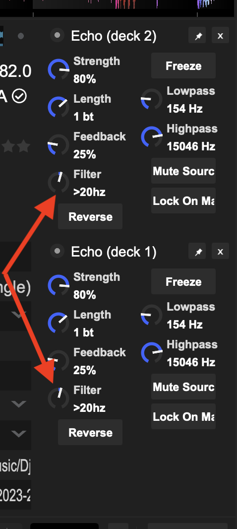

How can i change the default values of this filter to where i would like permanently?
The filter in the echo effect settings is set by default more to the 2 o'clock position on the high pass which is a bit to much for the sound i would like to produce when using this effect. I will set it to where i want it but every time i reopen the program i have to repeat the process only with this knob. All the others seem to stay set where i leave them. Don't know if it's designed to behave this way or if it's a bug, but really would like for the settings to stay as i leave it last.

Should be saved just like the other parameters, just adjust, and close vdj
Funny for some reason it's now staying as it should, but i swear it was resetting the filter to 1.5khz numerous times. I will pay closer attention to it.

Hi guys I'm back cause I found it strange that it was working on the last settings I left the filter but this is my latest observation.
I have 4 controllers and I did not notice that it was only with 1 of these controllers the filter was being readjusted - until now, and it's with my ddj 1000. So far I have not seen this same behaviour on the others - ddj 400/ ddj 800/ rev5.
Now that I've figured that part out, are there any suggestions that can be shared on how to fix this?
