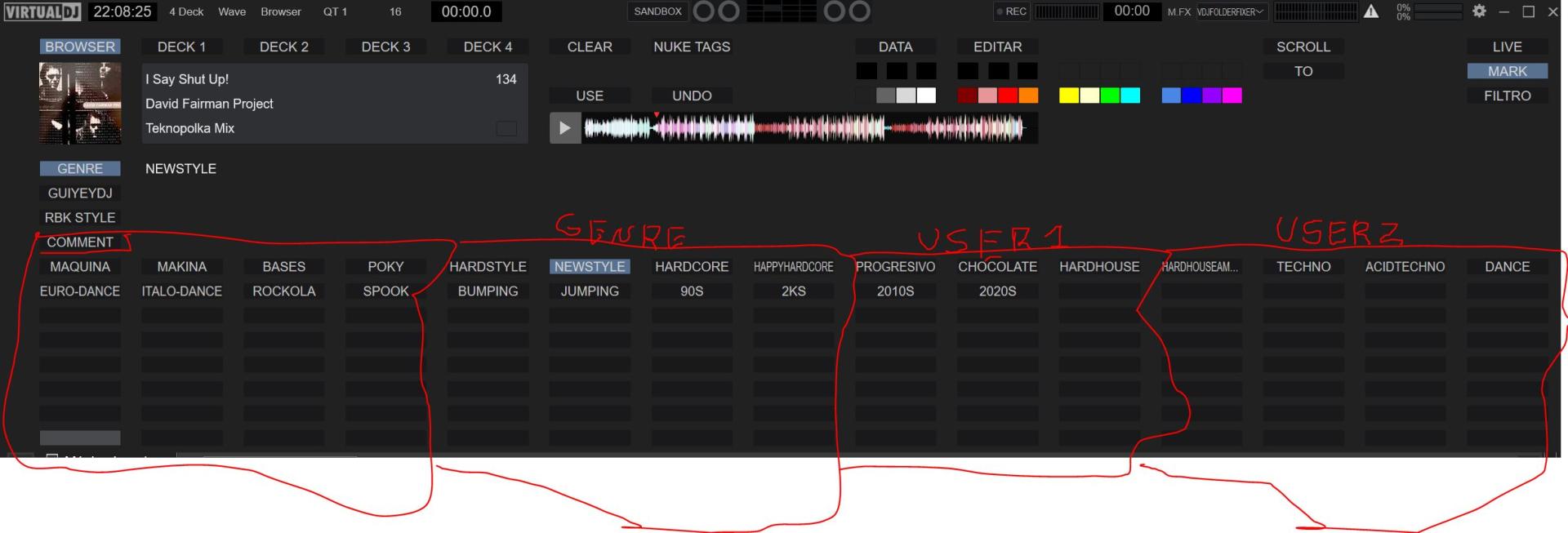

Thing I'm building
no prizes for prettiness but it's the mechanics that are the big thing,
120 assignable buttons for genre
120 buttons for user 1
120 same for user 2 and 120 comment,
Appends tags comma separated. doesn't comma an empty tag
40 step undo memory, that took some iterations
decks 1-4 and browser.
scroller to tag entire albums/folders with a string of tags
Filter builder for 4 tags and some bpm & key stuff
filter builder has undo memory
A few ideas yet and plenty of stuff to do but a nice day or so and the main mechanics are working well.
Anybody up for point & click tagging when it's near done? I've probably tagged more in the last 8 hours than I have done last year because it's so easy.

it's a skin, it sits at exact size of default 2 deck layout so you can swap between decks and tagging with a button with no skin reload that's the convenience.
It's never going to be a skin release as it just my forever WIP skin under there.
it's not the looks, it the mechanics
I'm building it in a way that any skinner can drag and drop into their skin, all the mechanics are hidden away.
All the complicated bits are just written once and don't need to be touched or copied
they just panel the main body of their skin, then design a new grid to look pretty and fit a new body sized panel, mostly column typing.

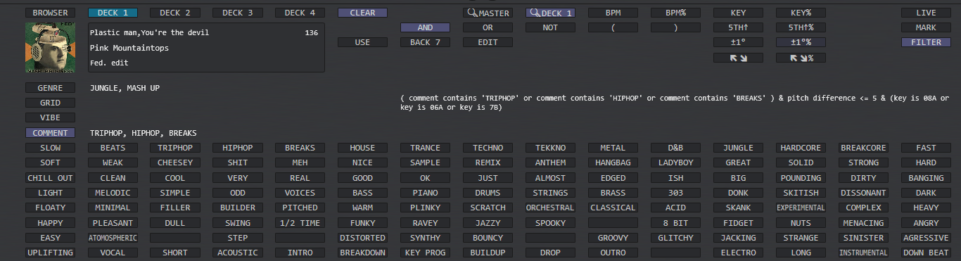

Getting on, I don't like the prelisten but it's there because it's expected
That filter was built in 7 button presses, the tags of the browsed song were lit up until I used the tags in the filter.
There's a tonne of fat finger protection in there, last pressed grid button can be undone just by pressing it again,
you can nuke all tags or nuke just one [single click] or edit a tag by text input [double click] all of it covered by the history, it takes a snapshot before changing anything [except colour and star rating, no need for that amount of hand holding]
A few key filters in there, direct key, up a 5th, adjacent on the camelot wheel , and diagonal on the camelot, then variations if you like to start from a pitched up perspective [like I do]

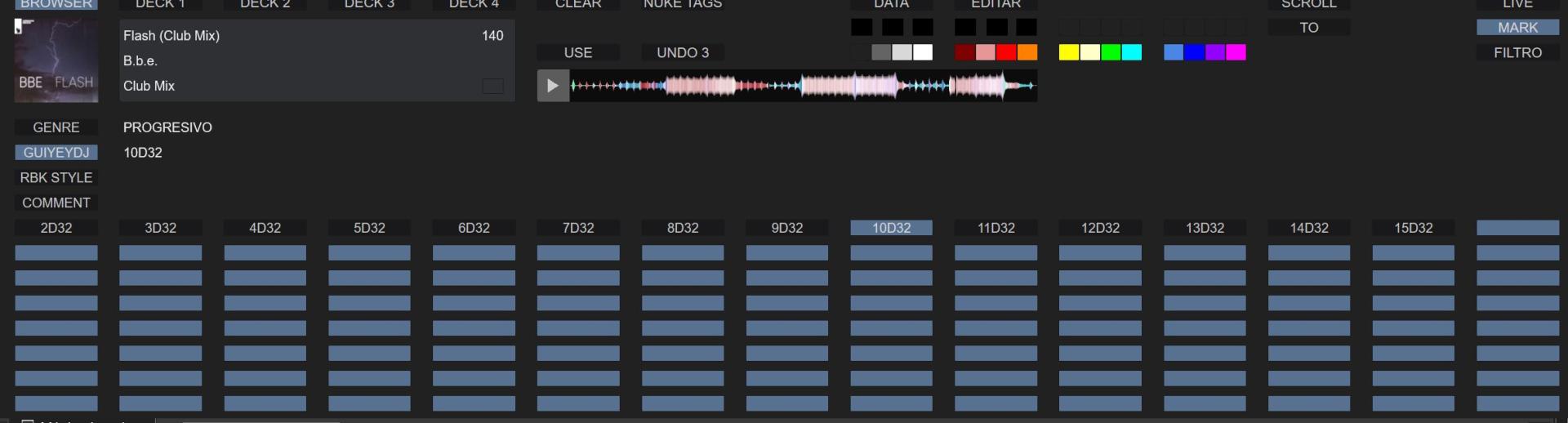

I edited the buttons of an old PhantomDJ prep skin (AI Helped) to make button. You can see in pic I used the top row for setting hot cues I use the most. What you doing now is similar but on major steroids. I like it.

This is the main panel we'll go thru each element
top right corner,
live gets you back to decks
mark opens the marking panel [which we are looking at in the 1st pic]
filter opens the filter panel, which is discussed after
Top line left hand side
this is what source we will be marking
right click any of these and it will open the tag editor for that source
these buttons [excluding browser] are also drop zones, you can drag a track from the main browser or the album art on to a button and it will load on the corresponding deck

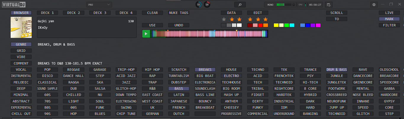

The 4 tag buttons
These are the tags we will be marking, your 2nd & 3rd will be named different but they are user1 & user2
left clicking selects the tag for writing
double click opens a popup that lets you type/edit the tag if there's something you want to manually type/delete
right clicking clears the tag [don't worry about fat finger]
Some of the main buttons from the grid of 120
right clicking will let you change what the button saves and writes
left clicking will write to tag, if you left click by mistake you can click again and it will be removed from the tag [this remove function has only a one press memory]
If the button is lit up it means the word is in the tag and can't be written again.

The filter page, not as serious as tagging but if you have done serious tagging then this will probably be useful
The logic buttons 'AND' 'OR' 'NOT'
One of AND OR should be lit up at all times, if they aren't click one [I'm not sure how that could happen, but it might.
with one of these on other button presses will work out
should I write ' & genre contains techno'
or should I write ' or genre contains techno'
the NOT button is an on/off switch to make the query negative
' & genre doesn't contain techno'
These two, on first start both will be off, only one can be on
when 'master' is on the 120 grid will light up any words that are found in the masterdeck [loudest deck] tag [whichever of the 4 tags we're focused on]
As you include these in your filter query the button lights will power down
handy to save you hunting for buttons.
the button that says 'deck 2' does the same thing but not masterdeck, but the deck designated as the source deck by the buttons above the track meta data mentioned at the start of this about filters
brackets, useful for combined filters
'genre contains house & ( genre contains handbag or genre contains vocal or genre contains soulful )
brackets keep a count of how many you have open, telling you how many you need to close to get a working filter
Buttons are smart enough to know,
if it should write ' & genre contains....' if in the middle of a set of queries.
or if it should write 'genre contains...' at the start of a query or next to an open bracket.
BPM will make you a filter of pitch difference <=5%
BPM% umm, I like to play tracks pitched, so a usual bpm filter would only really get me stuff that is a faster tempo but played nearer pitch neutral, not the vibe I want BPM% gets me pitch difference <=5% against absolute bpm then I can pitch up the new track just as much or close to it.
Whole lot of key filters
key direct key match
5th up a 5th +2 camelot users
1 degree +/-, basically adjacent on the camelot wheel 1a will return 12a, 2a & 1b
diagonal arrows, diagonal on the camelot wheel, 1a will return 12b & 2b
% variations, did I mention I like to play pitched up, same idea as bpm%
Star ratings because why not? not a rating user myself, context is too important to have just one measure of a track but it's there for those that do
Edit, you will have created a string and maybe there's something you want to manually type, maybe change an '&' to an 'or'
Use - actually use the filter you've created
it will type a * into search to get a database wide filter and apply the filter
you won't be able to use a filter if you have unclosed brackets [might auto close hanging brackets in next version]
BACK, again lovely fat finger protection, remembers upto 40 steps in creating your filter
this is a different memory to the marking memory
clear, like the clear in marking wipes the BACK memory and clears the string, also turns the filter off

hi, thanks i´m testing it, found a bug or maybe isn´t, sure you are adviced:
in some cases when i select a tag in my case 10d32 all empty buttons get colored like they been selected,
thanks for hard work!!
i forget ask for use for DATA button, CLEAR aparently do nothing and NUKE delete all tags, maybe Clear must delete only feature who is located now...example if i was in genre only delete all genres from this track...
thanks again
thanks again
geposted 6 days ago @ 7:52 pm
