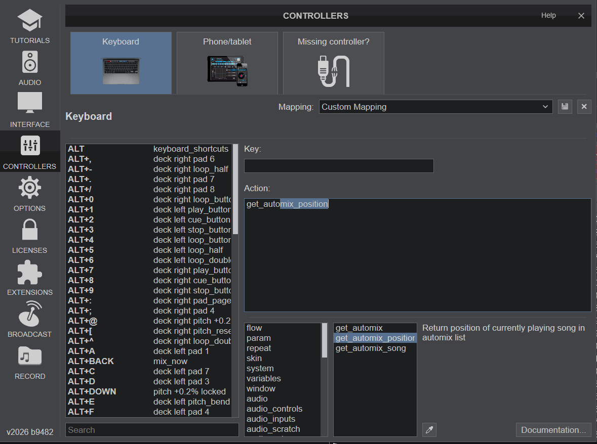

Where should the onSongLoad script be written?
I can't figure out how to access the location where it should be entered.
Is there a place for it inside the skin file, or should it be added somewhere else?
If possible, could you explain where and how to set it up?

keyboard mapping holds onsongload
