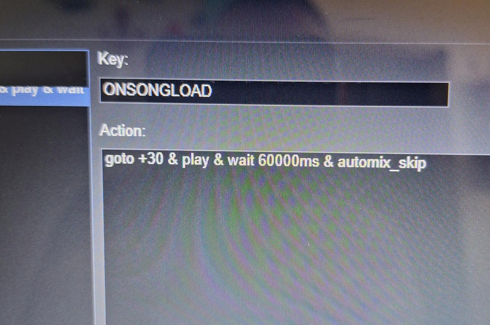

Thanks everyone for your help and input. I think I pretty much got it figured out to do what I want it to. Only small issue I have with this is when it skips to the next song, for a split second it automixes the beginning of the song, but then skips to the 30sec mark like I want. Not really a big deal and the common bar fly bingo player isn't going to notice.
geposted Wed 22 Jul 26 @ 11:24 am

Just FYI:
goto +30 goes 30 beats ahead from the current position, not on the 30 seconds timestamp.
That would be goto 30000ms while goto +30000ms would move you forward (from the current pos) by 30 secs.
geposted Wed 22 Jul 26 @ 12:38 pm
