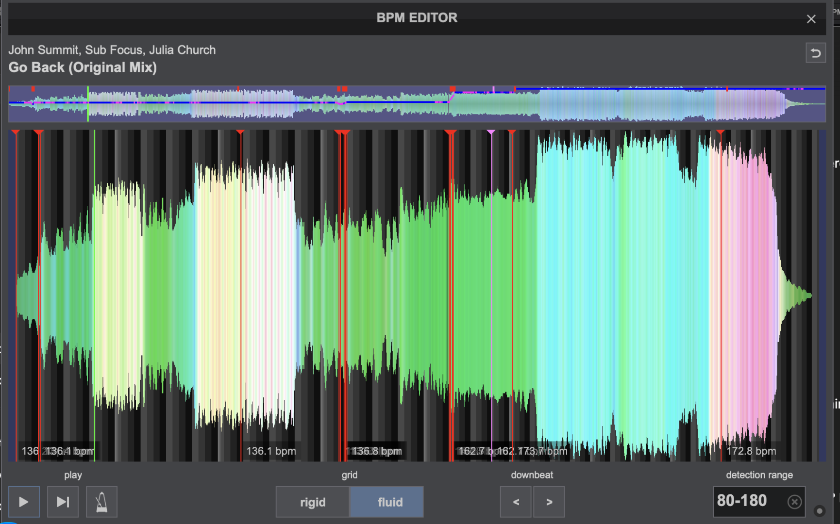

It's incredibly annoying that they didn't put in an option to manually edit fluid tracks. I hope they roll that out in an update soon. For instance, I just analyzed Go Back - John Summit and Sub Focus and it has a regular house beat then goes into drum n bass. I cannot do rigid because there's an adjustment, but when I do fluid the beat anchors are so screwed up that even when I delete a bunch of the unnecessary ones, I can't move the anchors to be where they need to be. Adding new anchors also doesn't do it right. It was much easier when I was able to just go "ok, this has multiple tempo changes, let me just add the beat markers where I need them." So stupid that they made it such a headache to get that done. It needs to be fixed.

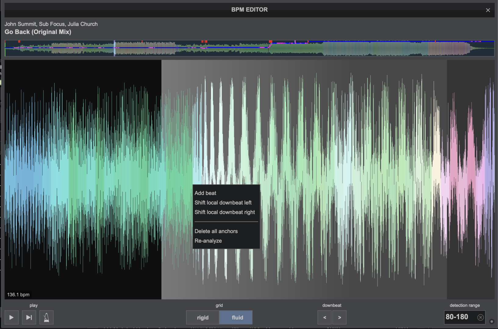

These are the only options it gives when I right click. I can delete all anchors, then it lets me have the add anchor option, but I can only add one before the option is gone again. It seems like unless I go in and adjust the beat grid to match every single beat, I can't edit this song to be where it needs to be. Needs drastic fixing.
geposted Sun 26 Jul 26 @ 8:45 pm
Where did you right click (on a measure line or within a measure)? What does clicking "Add Beat" do?
geposted Sun 26 Jul 26 @ 8:50 pm
I clicked on a measure line. When I click add beat it doesn't seem to actually do anything either.
Also am I not able to change the fluid tempo? When it's drifting off because it reads it as 173.2 but it's actually 174. Overall this whole fluid stuff is more of a headache than it's worth
geposted Sun 26 Jul 26 @ 9:05 pm
So you do have to hover the mouse over the measure line, and when you ser the pointer turn into the cross, a roght-click should contain the Add Anchor entry.
geposted Sun 26 Jul 26 @ 9:46 pm

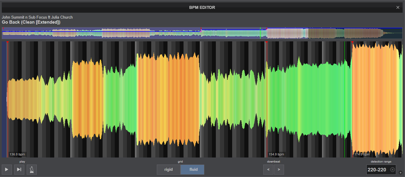

Ok my procedure for that track
first go to rigid, get that first beat spot on the first audible sample
use the zoom cheat trick
squash the window tiny, zoom all the way in, drag the window size as wide as possible
@devs can we just get per sample zoom without ^these^ tricks
scan as fluid, delete everything,
pull the grid till you get it to 136.000,
a custom button named
`get_bpm & param_cast '0.000'
to actually see more that 1 rounded decimal place
now the first down beat of the long break that piano stab, sit there and goto +64
you want an anchor where this lands on beat
then you want to
goto +96
wherever this lands you want to drag that back to the drum & bass drop
that'll give you a bpm of 153.957,
make than an anchor
back end drag the bpm after the d&b drop till you get 174.000
that middle section isn't 153.957, but it is 96 beats with an increasing tempo
if you want to grid that speed up section, I'm not the man to ask
but I think you'd just be shift dragging 96 beats into ~there-abouts position
it's just a first beat and 2 anchors.
