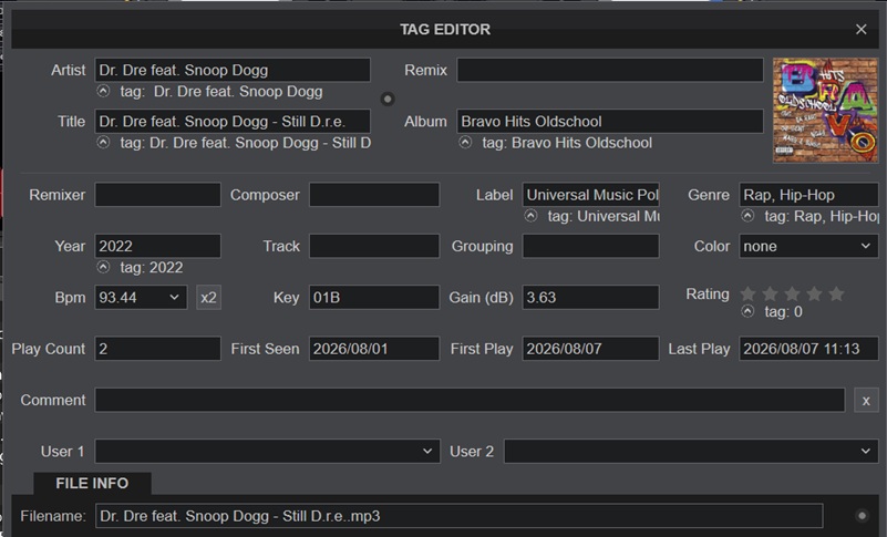

I have a request and a question. First of all, I would like to ask the authors of the Virtual DJ program to fix this because I think there is a mistake somewhere because the other songs are fine. I have such a tag,
and during playback I have something like this
As you can see in the tag with authors it shows unnecessary data. And where the title is supposed to be, it shows one of the performers of the song.

Disable cleanTagsInDeckDisplay to allow it to display the tags exactly as what it is in those fields.
That won't help in this case, since the information is actually duplicated in the tag, so you need to edit it in the tag editor to remove the artist from the title

It would not be identical, but you'd still have unnecessary duplication on the deck display, just a little different

You literally showed the tag editor showing the tag is wrong...

If all your other tags are correct, and just this one file has wrong info.... make the corrections and save the tag.
Where did the file come from? Looks as if you've only had it a few days.

Your screenshot above clearly displays that the "TITLE" ID3 tag field also contains the Artist name (including the featured Artist as well)
We are not making this out. It is there on your screenshot.
So yes, you first need to fix that.
It doesn't matter why this song has wrong info. It has. And you need to fix it. MANUALLY.
Now choose your path wisely..
And you know why I do this. Because I use rekordbox. Because for the console XDJ-RX3 the song title is displayed in the bar. And I want the artist and title of the song to be displayed.
That's funny actually..
So, you did enter irrelevant data to irrelevant fields. On purpose. Because of Rekordbox!
And now you demand that VirtualDJ should show your wrong data correctly!
Instead of going to Pioneer and asking them to provide the XDJ-RX3 firmware with an option to show "Artist - Title" on it's main screen which is what you want to achieve..
And the funniest thing of all is that in VirtualDJ you can remap the controller to show "Artist - Title" on the screen, instead of "Title" without botching your ID3 tag data.
