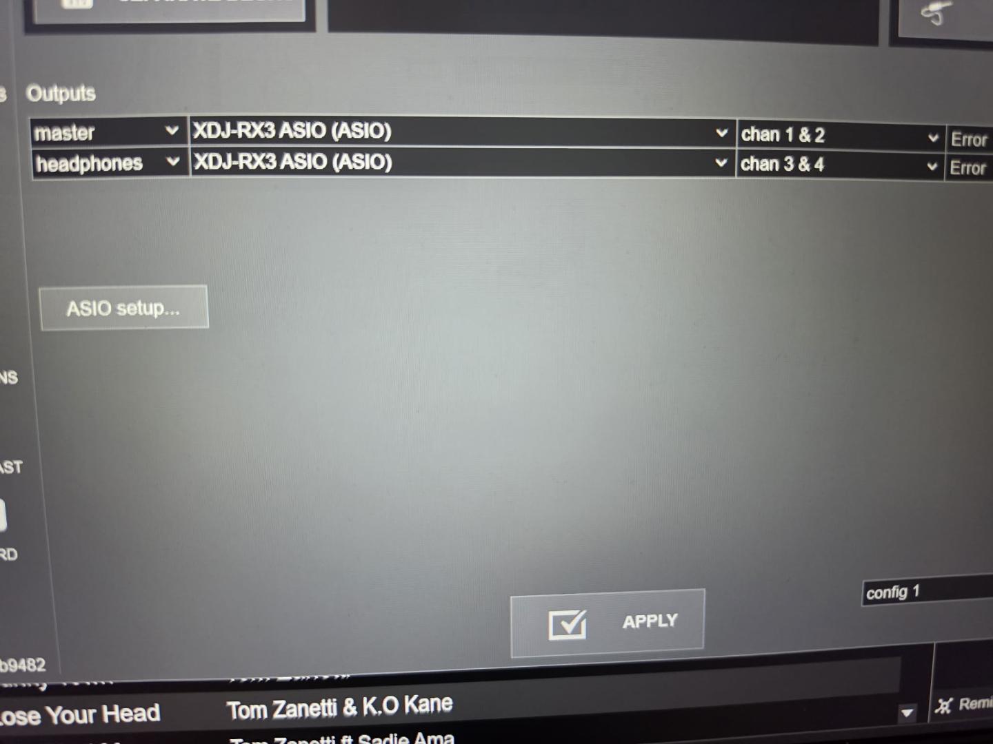

In the aduio setting is this the correct setup for use of decks 1&2 and with headphones set 3&4?

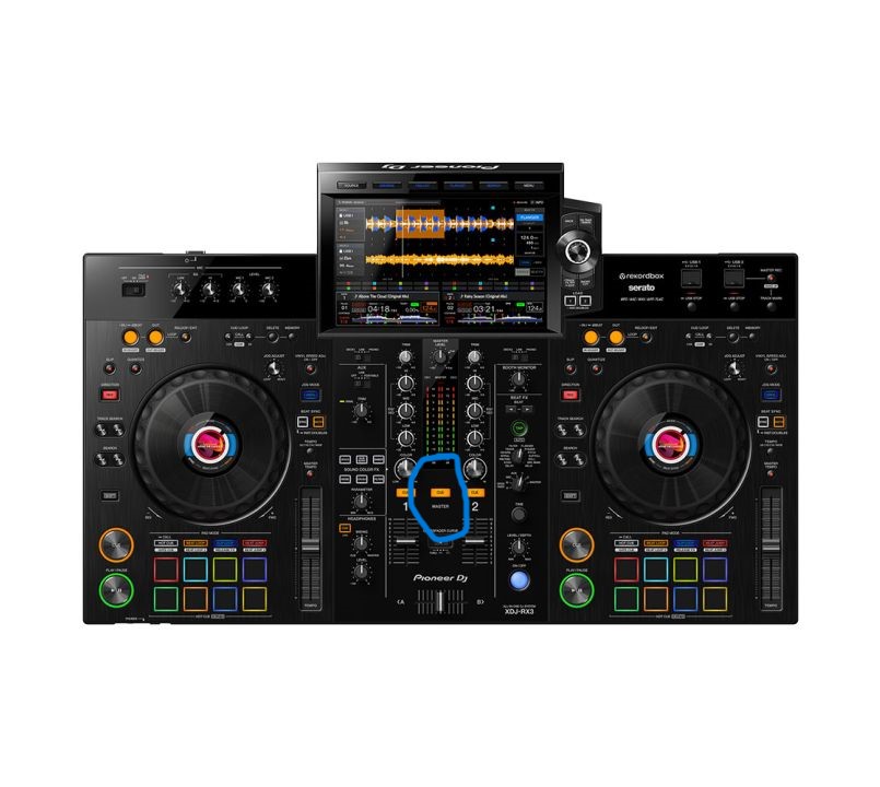

also need help on how top get the middle cue button to work on the headphones on the RX3 ?

1) Yes it is correct
2) It works fine here. But in pure Pioneer fashion, you also need to use the headphones mixing knob (16)
