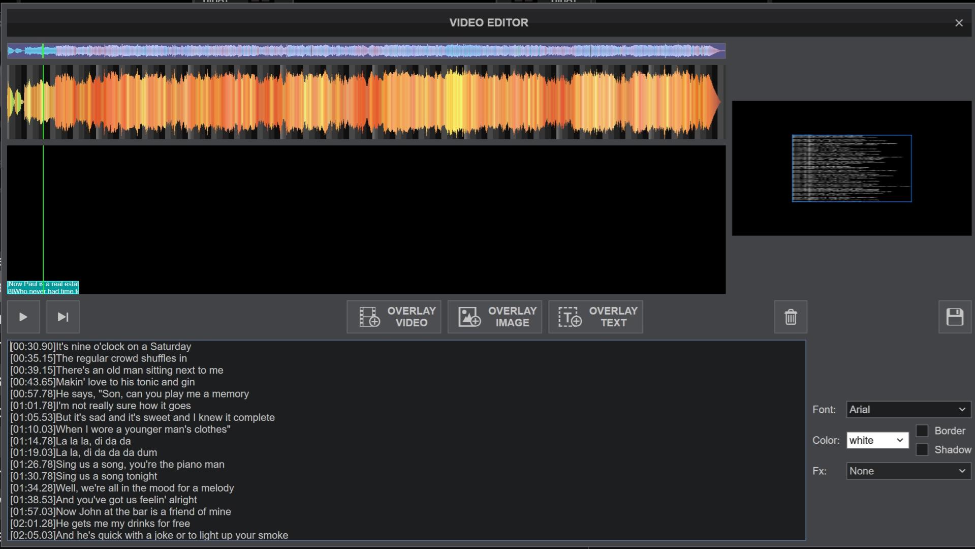

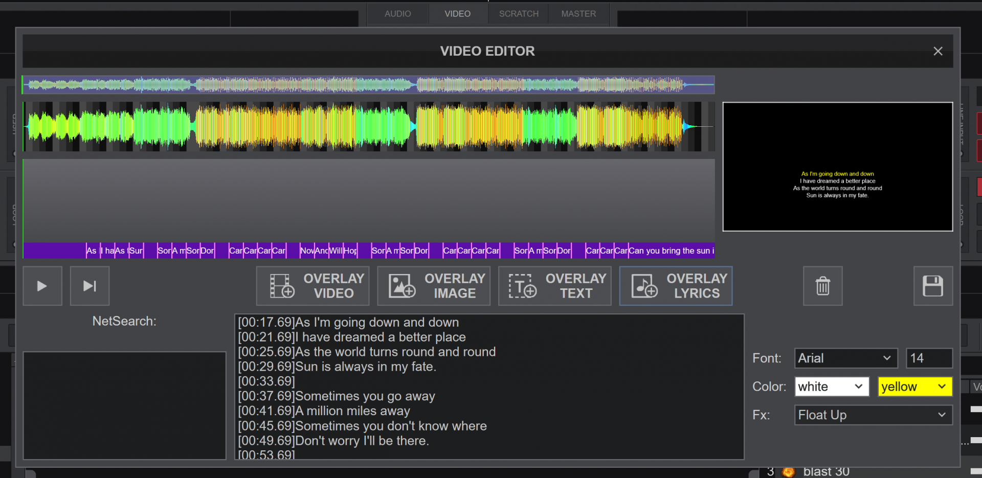

After some questions about how to enlarge the Fonts for .LRC files, which didn't bring any answhers yet I'm attempting here. Perhaps it's more kind of a Video Discussion?
I did found some topics about users and explaining about the Video Editor and how they use it. Seems a perfect fix. :-) But I can't find the "Lyric Overlay" button in my Video Editor.
Reffering to this topic it once was available. https://virtualdj.com/forums/236163/Wishes_and_new_features/Karaoke_lyrics_overlay_on_top_layer.html
Thanks in advance. :-)

This has been replaced with the Lyrics Editor (alongside the Karaoke and Lyrics plugins)

Ok, thanks..
I found out about the Lyric function and managed to paste the .LRC timestamped text. But text is still a bit hard to read. And with larger fonts, words sometimes overlap.
Ideally I would like the .LRC format screen but in a less taller version, so it doesn't occupies my complete playlist. When I wide up the LRC screen the Font will stay in the same size.
I actually just found about the Video Editor. But this was my orignal question: https://virtualdj.com/forums/269801/General_Discussion/How_to_enlarge_Fontsize_for_.lrc_files_in_the_Master_Video_Output_window.html
I don't use a separate Video Overlay on a screen so it's only for for private view. ;-)

Found out how to display the lyrics a bit clearer. 'Beats' for waveform gives a much easier to read contrast. :-)
