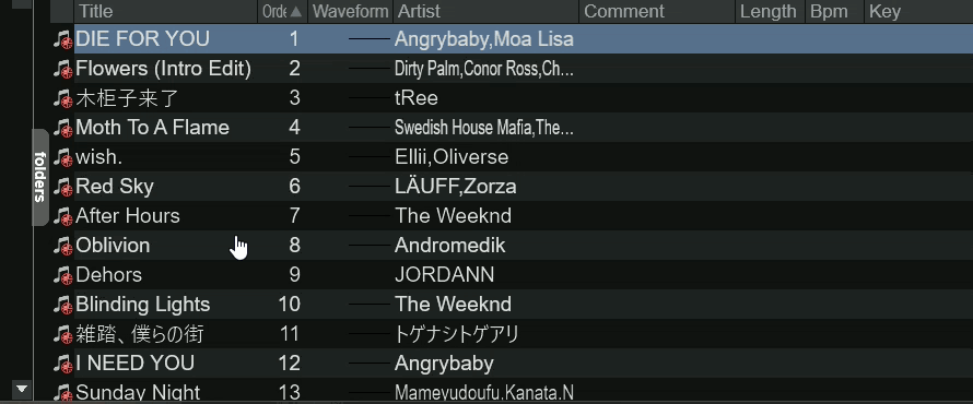

When my plugin fills tracks into the folder, if the sorting option "Order" is checked, the first track and roughly the middle track in the list will swap positions. If I click the blank area at the top-left corner of the table header, the order returns to normal. I tested it and it seems this also happens with the SoundCloud source. I've checked my code but haven't found anything related — I'm adding entries in the standard order. I'm wondering if this could be an issue on the VDJ side.

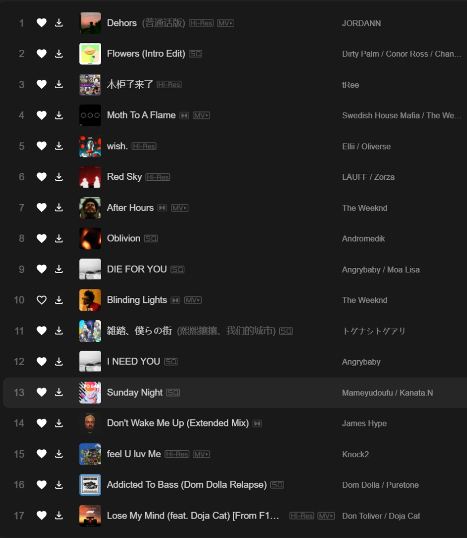

The correct sorting order should be as shown in Picture 2.
First Track is Dehors - JORDANN

Right click on the title of "filename" column and select "Reset sort order"
It will be the order of your plugin.
