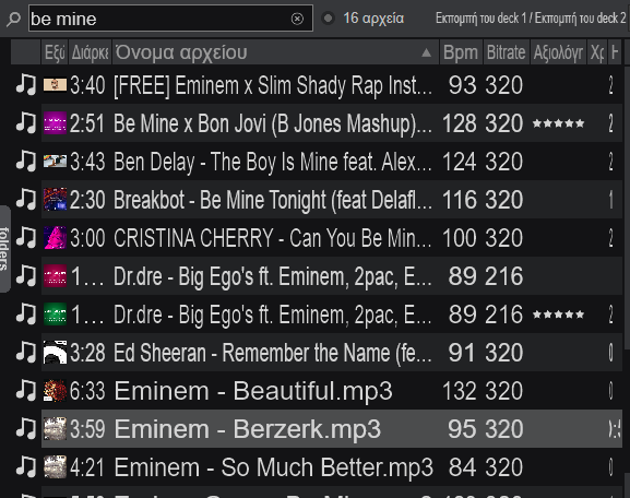

hello i have an issue i search be mine and random songs pop up like eminem berzerk i cannot fix it i changed search options to file name only and still random songs come up i also checked for possible tags that in the eminems song but nothing close to be mine and it happens with other searches aswell please if anyone knows the answer help me thank you

yeah but this doesnt make sense,a lot of songs can have these letters inside, can i make it somehow more strict?

Well what exactly are you searching for? What is the full artist and title?
It's always better to search for something distinctive or unique rather than short words like 'be'.

Use double commas
"be mine"
