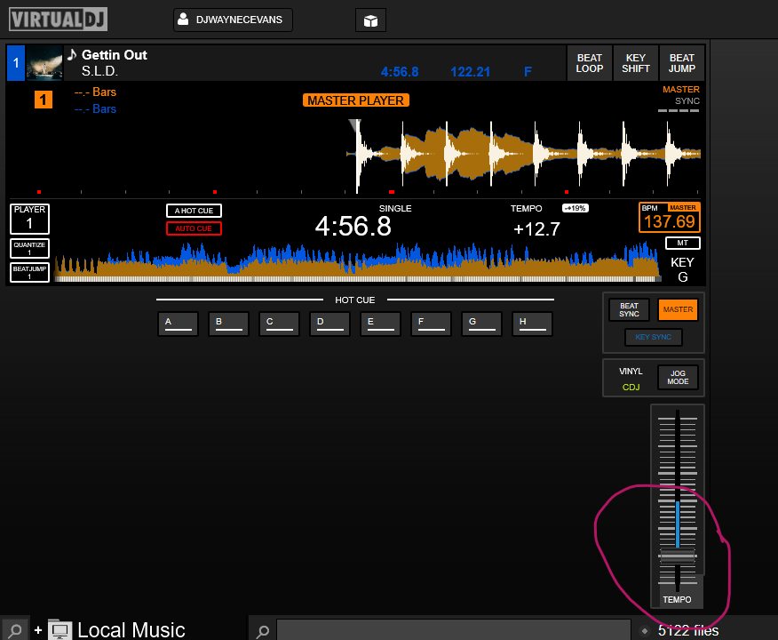

It is still being built, but heres a screenshot of where I am up to....

It has become a bigger problem than first expected, as you can see in the screenshot, you get a weird shadow when using gradients. It seems you can not use a gradient below any function. I have a gradient background on the full skin.
Anyone have any suggestions?
