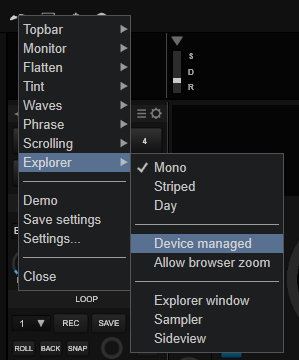

As for zoom, I can't think what else there is that causes it by default, are you using a custom skin?

Hi mate ive tried your new scripting & it doesnt seem like anything changed the button didnt light up when i sent a message !
Arghhh yes im using a none VDJ skin althought i did get it from there offical d/l site ive just tested it on a VDJ Offical one & it works fine oh Bugger thats a pain i was going to use that offical skin but i rely on timmings for stuff i do that skin is perfect for what i do the layouts of the others dont work for me i cant find track timer that big enough placed so i can see it easy

So your custom skin with have a skin setting that triggers the autozoom, it should be in the layout options.

Found it
"device managed" needs to be off

wow!!! You are Da Man how the hell did you find that 🤣Your like a Dog with bone as they say well you are Locodog 🤣
