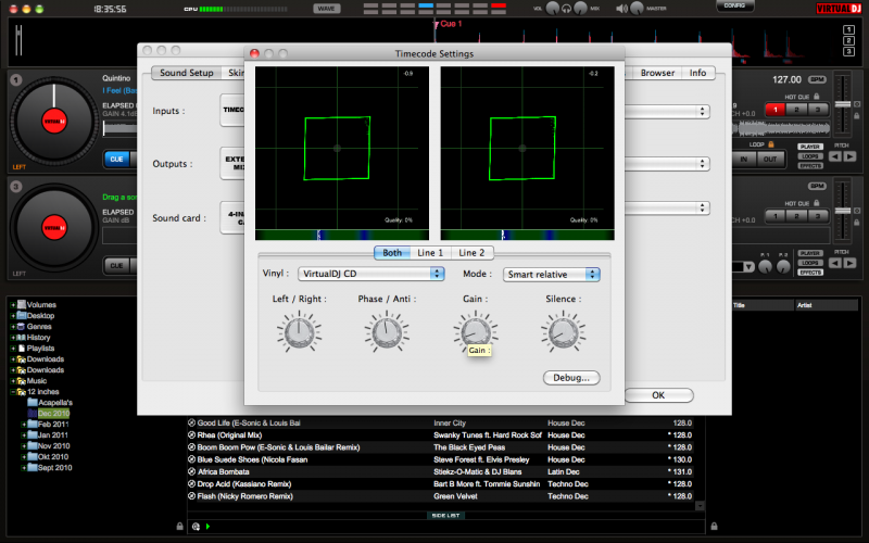

Ok, so I have 10.6.6 but have some trouble with my Maya as well...
I do get a signal in, but its very strange, and not consistant.
Is there any way to make timecode work with the maya?
this is a screenshot I got this afternoon:
