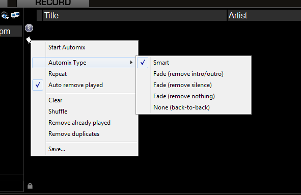

Ian, you're responding to a post that's almost 4 years old. There have been some changes over the years to the automix-function.
If I read your post right, you haven't changed anything in the automix-setup.
These are your options. Choosing the last option (None Back to back) won't fade in or out your music and you still wil be able to manually change your automix points.
Hope this helps you stick to VDJ ;)
geposted Mon 05 Dec 11 @ 10:39 am
