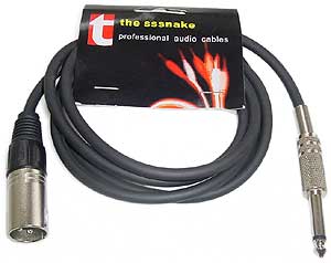

- 2 cables with 1/4 inch jack mono male plug on 1 side, XLR on the other side, as on this link http://www.thomann.de/gb/the_sssnake_mxp1015_audiokabel.htm,

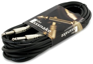

- or 2 cables with 1/4 inch jack mono male plug on 1 side, 1/4 inch jack mono male plug on the other side, as on this link
http://www.thomann.de/gb/the_sssnake_sk3613_kabel.htm
You have no reason to use RCA to 1/4 inch jack cables as the RCA output level is -10dBv while your speakers are designed for +4dBu input level, the output level of the Rmx 1/4 inch jack plugs.
