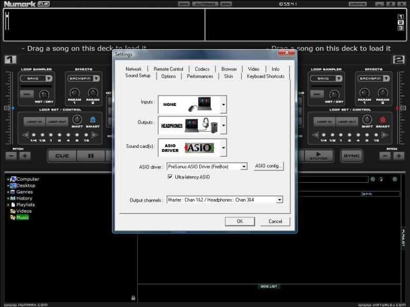

Hey Tear em up.
I managed to get a screen shot.
This is how its setup in cue.
works the same with DJIO, but obvioulsy it dosent show firebox :P
so the issue is that when i have it like thjis, i cannot control the volume or PFL on my TC, i can only raise the volume of the headphones from my sound card. Seems like the volume headphone or PFL are disabled on Tc when used with thsi sound card.
it could be just as si mple as this sound card dosent work with this setup
