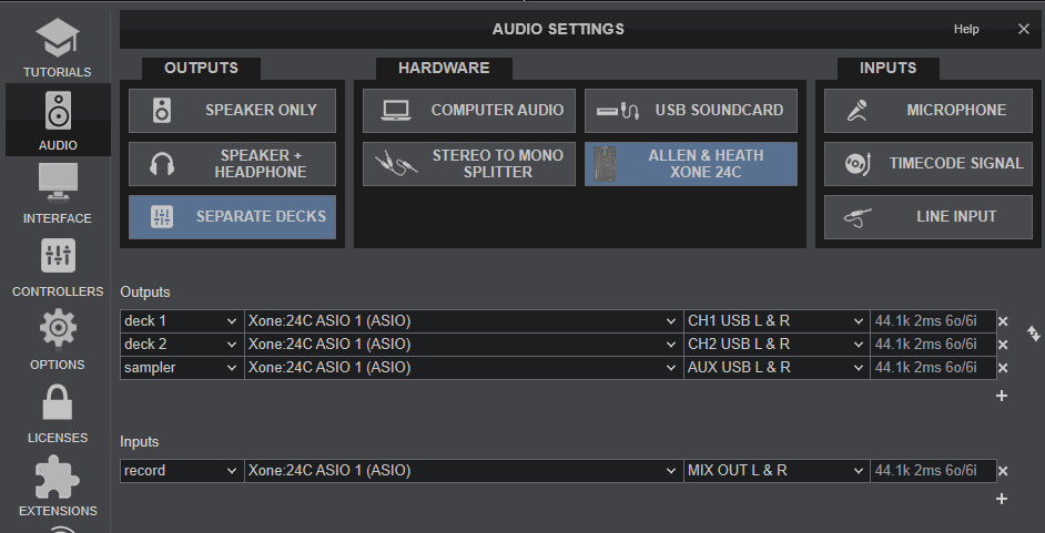

The following image displays the default Audio setup for the Xone 24C, which requires speakers to be connected at the rear panel.
Fow Windows only : With the ASIO driver installed, open the Xone24C Control panel and make sure the ASIO 1 is selected. If the ASIO 2 is selected, make sure VirtualDJ is also using the same driver in its Audio Setup.
To open the XONE24C Control panel in Windows, you can click on the "ASIO Setup" button in VirtualDJ Audio setup, or search for the "XONE24C" Control panel app from the Search Windows in Taskbar.
SAMPLER
The default Audio setup of VirtualDJ as shown above, is using the 2 Mixer channels to route the 2 VirtualDJ decks, and the VirtualDJ Sampler to the 3rd stereo output of the device when the left-side AUX/USB/MIC switcher is set to USB. Having Sampler on its own dedicated Mixer channel provides the ability to turn the output On/Off (ON button), control its volume, apply hardware EQ, preview its output ( Cue button) and apply the Xone24 HPF/LPF Filter (FILTER button).

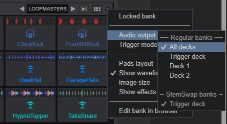

If your setup requires the use of MIC/AUX Input to your workflow, you can remove the "sampler" output from VirtualDJ Audio setup and set the switcher to either MIC or AUX. In this case, you will need to change the Sampler Output to "All Decks" (or other option) from Sampler Options and the VirtualDJ Sampler will be routed to both CH1 and CH2 of the device
Alternative Sampler routing

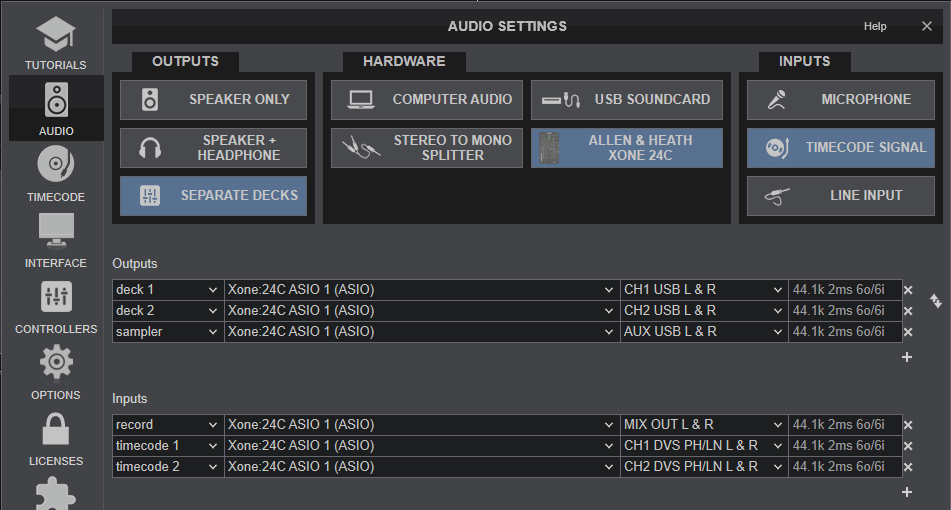

  • Connect your Turntable with Timecode Vinyl to any of the 2 rear-panel Inputs and set their USB switcher to PH or your CD Player with Timecode CD and set their USB switcher to LN
  • In VirtualDJ Settings->AUDIO tab, press the Timecode SIGNAL button for Timecode Inputs to be added as per the following image.
VirtualDJ Audio Setup with Timecode Inputs

The device is offering a dedicated Record Input, which is added to the default VirtualDJ Audio setup.
This input allows you to record your mix from VirtualDJ Decks, along with any other AUX/MIC source, as long as the "record" input is in your VirtualDJ Setup and points to the "MIX OUT" channels.
If recording is not working as expected, perhaps the Audio routing of your Mixer is set to a mode other than MODE 1 and needs to be reconfigured.
