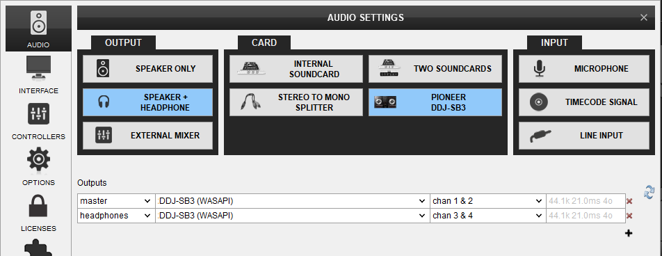

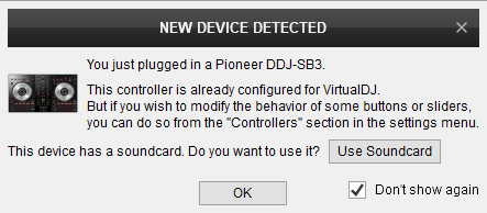

A detection window will appear next asking to use or not the pre-defined audio setup with the built-in sound card of the DDJ-SB3.
Click on the DDJ-SB3 button if speakers are connected to the Master Output of the DDJ-SB3. You can still change that from Settings->AUDIO tab.
Click to OK.
The unit is now ready to operate with VirtualDJ.

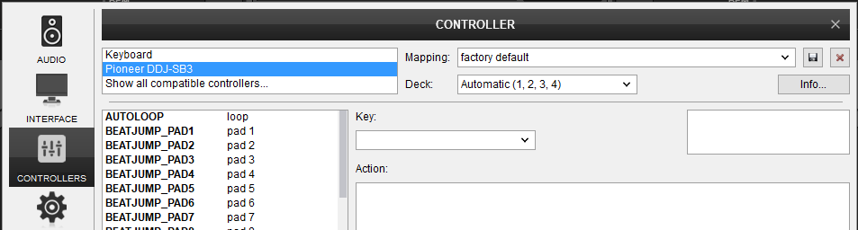

MIDI Operation
The unit should be visible in the MAPPING tab of Config and the “factory default” available/selected from the Mappings drop-down list. The factory default Mapping offers the functions described in this Manual, however those can be adjusted to your needs via VDJ Script actions.
Find more details at
https://www.virtualdj.com/wiki/VDJ8script.html
AUDIO Setup
The unit has a pre-defined Audio setup and a special button in the AUDIO tab of Config to provide that.
