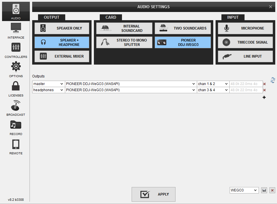

A detection window will appear right after, asking to use or not the pre-defined audio setup with the built-in sound card of the DDJ-WeGO3 Click on the "Use Soundcard" if your speakers are connected to the Master Output of the DDJ-WeGO3.
You can still make changes in the Audio setup from VirtualDJ Settings->AUDIO tab.

AUDIO Setup
The unit has a pre-defined Audio setup and a special button in the AUDIO tab of Config to provide that.
Alternative Audio setups can be applied in the same window.
