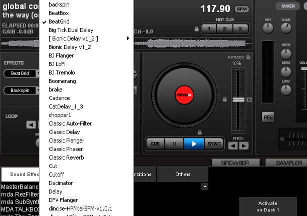

Maybe it's better to explain you what I want to get.
-Pushing a button on my MIDI device I want it shows me the list of all effects like this:
-After that, pushing a letter on my keyboard I select the effect
-I enable that effect by MIDI controller
-I want to do the same with another effect letting the first effect enabled
P.S: goto +8 works good.
The function 3 you wrote does nothing.

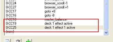

I set like you said but when I push those buttons, VDJ does nothing:
The same is for the "search" instruction to go in the search and looking for songs by typing the title.
