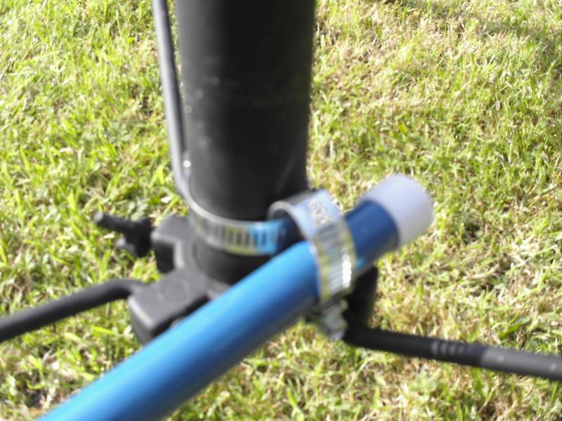

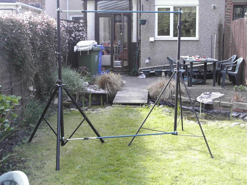

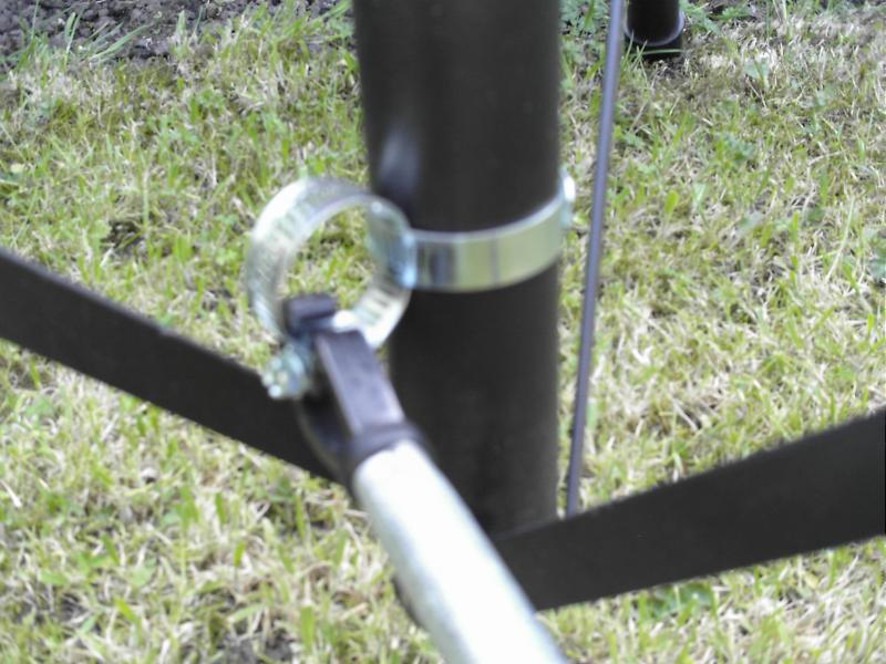

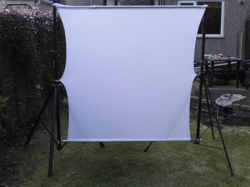

Height is 70\\\\\\\\\\\\\\\" and at the middle is 64\\\\\\\\\\\\\\\"
Depending where I\\\'m playing when doing the odd mobile it is just not practible to set up a full show with lighting truss and extra stands so I came up with this idea to lessen the work.
Attach jubilee clips to top and bottom of stand x 8 £4
Get to washing line extendable props for £2.99 each total £5.98 (they can extend to over two metres)
Spandex 1.5 X 1.5 metres £15 (hem at top and bottom, slip prop poles through, elastic tags at sides)
Total outlay £25
of course position poles for no shadow at gig, lol.

hehe, cheers mate, gonna attach two more elasticared tabs either side and should be done for that size, going to get a 1.5 x 2 metre piece and a case of same again, should look a bit more balanced, will do for the little bit bigger stages.
I think those clothes props are a God send.

You can get them at any hardware store, B&Q, Homebase etc, the only thing I will be doing different in the future when I get the time will be making four collars with a wing nut tensioner so they are more easily adjustable to slide up and down the stands for the prop poles to slip into, but the way I have the jubilee clips does for now anyway, maybes a splash of black paint to hide them a bit.
Glad the idea has helped, gonna put a patent on it before them on ebay nick the idea... lol.
I can describe how you can make those collars if you want, just let me know.

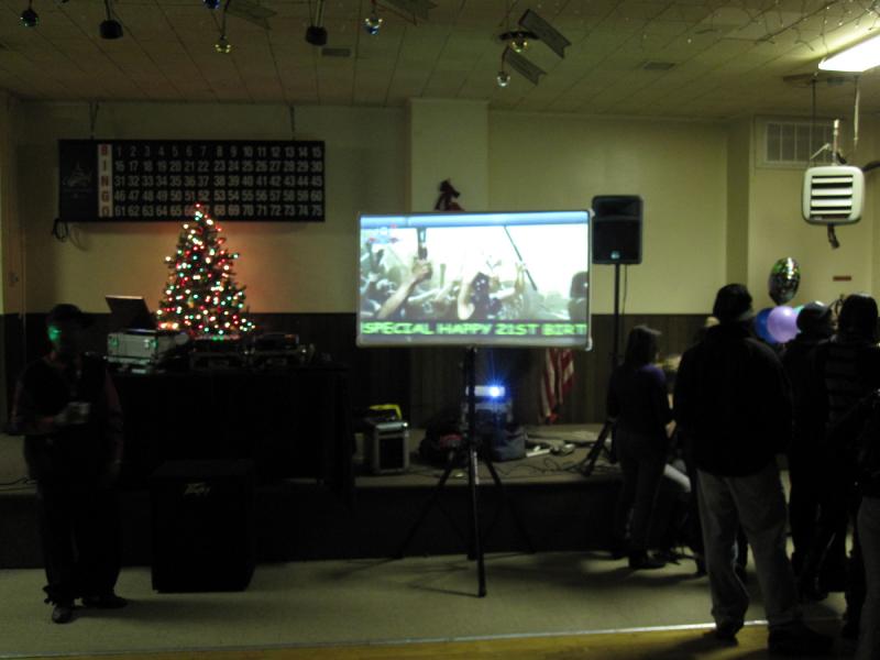

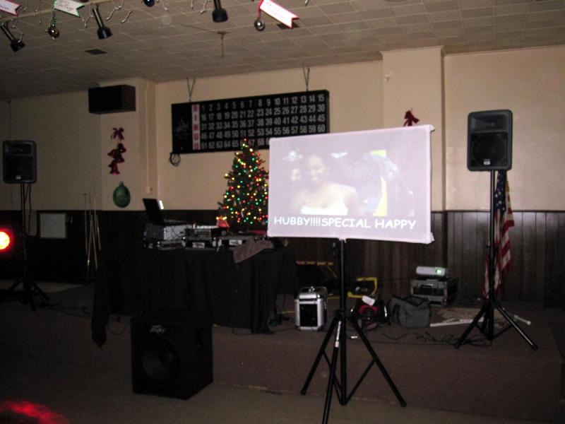

i made mine out of pvc that comes apart white spandex and velcro. it can be hung or put on a pole and is front and rear viewable. the 2nd pic is fuzzy from me moving while taking the picture. the spandex works great but your usually limited to about 54" wide.
