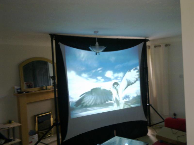

Here\\\'s a few pictures of what I've used a few times.
This first one I've made a backdrop from black material and used Tayla's washing line pole trick to put it up there. The backdrop makes the screen seem quite a lot brighter because it blocks any light that might come through the screen from the rear side.
And here's one at a gig, since I wasn't in front of a window I decided not to bother with the backdrop part. Actually the backdrop would have helped here because the pink venue lighting par cans are washing out the picture on screen. As you can see, still worked alright without a cross-piece, just don't pull the bungee cords too tight!
