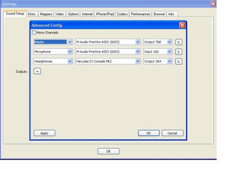

Tried this config in advance setup and everything worked, but the mike inputs 1&2, couldn't get it to record, I can hear it fine on the speakers...But not in the headphones either...

I use a 8 channel mix board. The mics and output (music) from the comp are the inputs. The main outs go to my powered speakers. The recording outs go to the line in on the computer. On VDJ 5 & 6, when in the audio record mode, you could configure what inputs VDJ would record (Master, Master + Mic or Line In). I always used the line in and could record the mix from the mix board. With VDJ7, they removed those options.
Thanks for the come back!
geposted Wed 02 Mar 11 @ 10:28 am
Yeah just do it how Joey posted. Then under Record loopback choose the soundcard that has your main board running into it and your good to go.
Your mic input on your laptop isn't necessary anymore, besides I bet you can't record with your line in and onborad mic anyways (unless its a TRUE line in, and most laptops share it) at the same time.........
