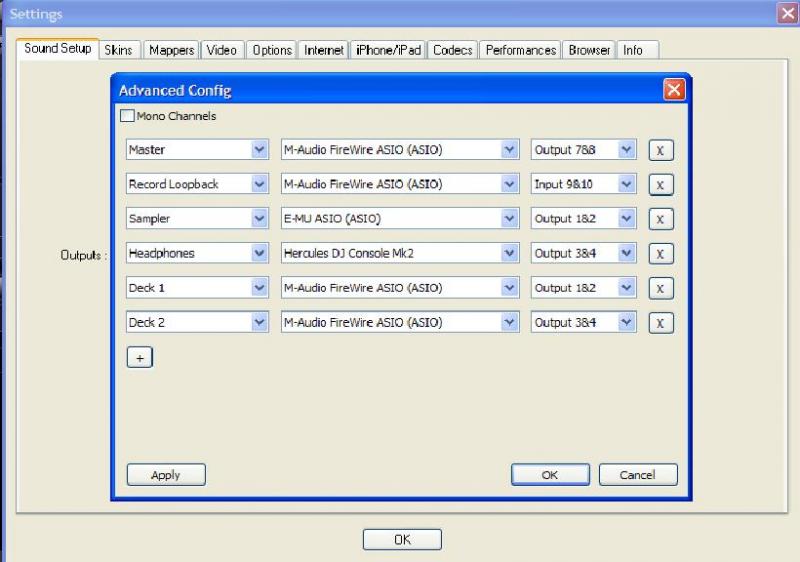

I worked with Chris Anson with Virtual DJ, he was able to log into my computer and set it up under advanced settings as follows"
Deck 1 ADJ ASIO Output 3&4
Deck 2 ADJ ASIO Output 5&6
Record loopback ADJ ASIO Input 1&2

....So the Decks that will be used to play the audio track that will be recorded needs to be defind in the advance dialog..???

Tried that didn't work, still get the error.......

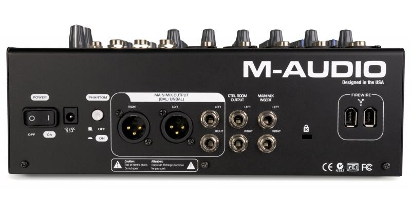

It's a M-Audio NRV10 anolog/digital mixer....http://www.m-audio.com/products/en_us/NRV10.html
I've had it for 2+ years now.
Joey....

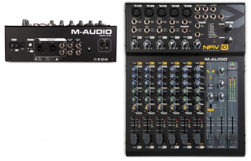

Here's a better picture of the main board, the previous didn't render for some unknown reason..

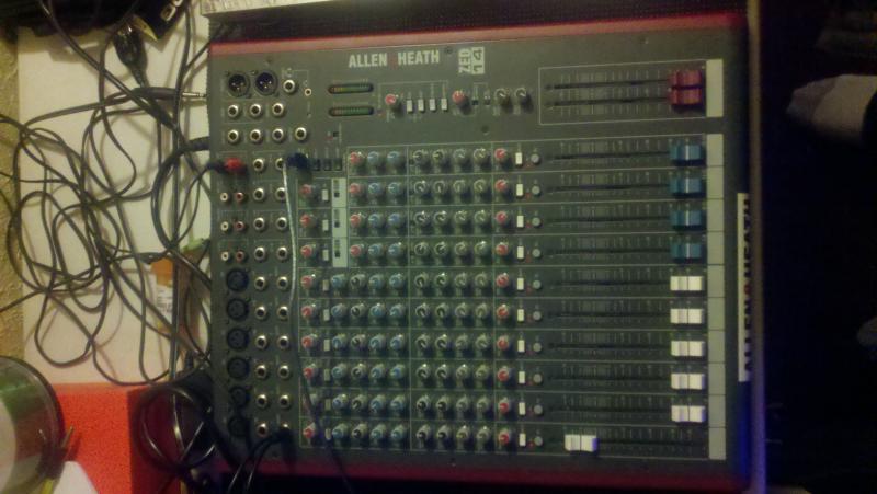

Hmm might have to sale the Allen/Heath ZED 14 and pick up one of these!
Nice mixer bro!
Huey

No doubt, that is a good mixer, but it's a large unit. I have all my equipment setup on a 14.5"x11" footprint, 8"x9.5" Mk2 controller and I'm good to go, plus I could record a group performance or a DJ/KJ session..
